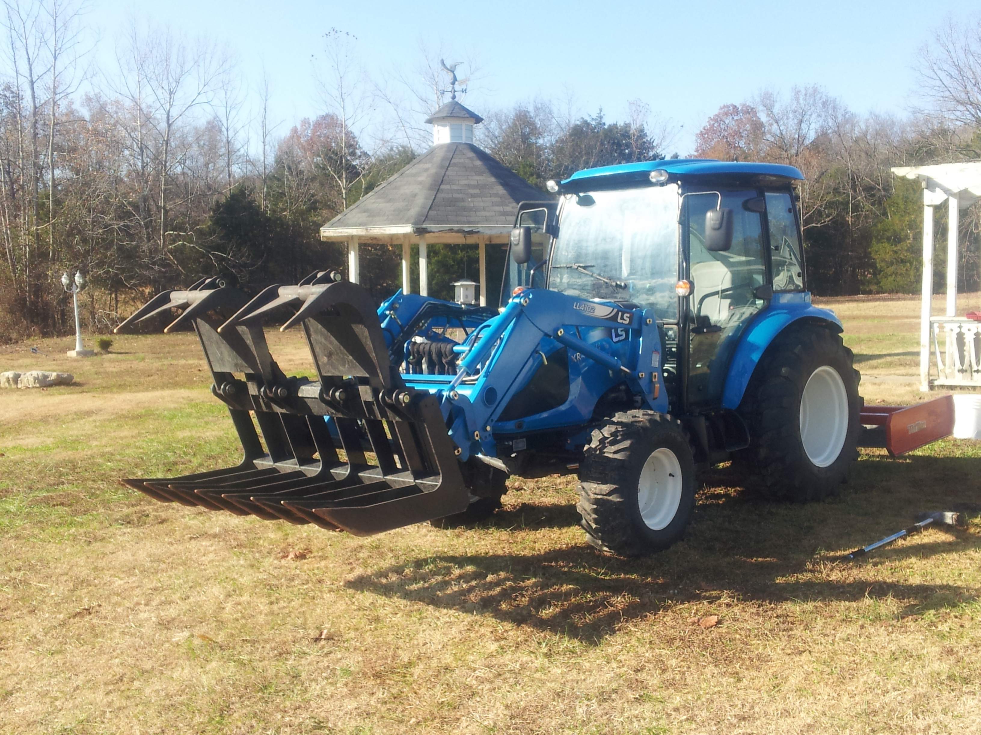

I was looking at getting the 48" LW Titan Root Grapple and was curious if any owners have had any issue with this attachment. I think it is priced right ($920) and was also considering the 50" EA Grapple ($1,395) but for its price I could almost get the Titan and a set of forks for the same money. Again anyone had any issues with the Titan aka palletforks grapple.

I have had mine for about 8 months.... the only issue I have had so far is they dont lock tightly onto my quick attach. Easily fixable - I just havent bothered yet.
I would have likely held out for the EA grapple - had I known one was coming. That would have been mostly based on the reviews of the EA grapple.
I will say that I am not happy with how the Titan grapple closes top tine to bottom tine. They dont meet, and make it difficult to pick things up with it.
Really its hard to say in the end, as my Titan is the only grapple I have ever used.
As to quality of build - it is top notch, as with the 2 other items I have bought from them. I suspect the slop in the quick attach has more to do with making it truly universal than anything. All 3 items from them are like that.

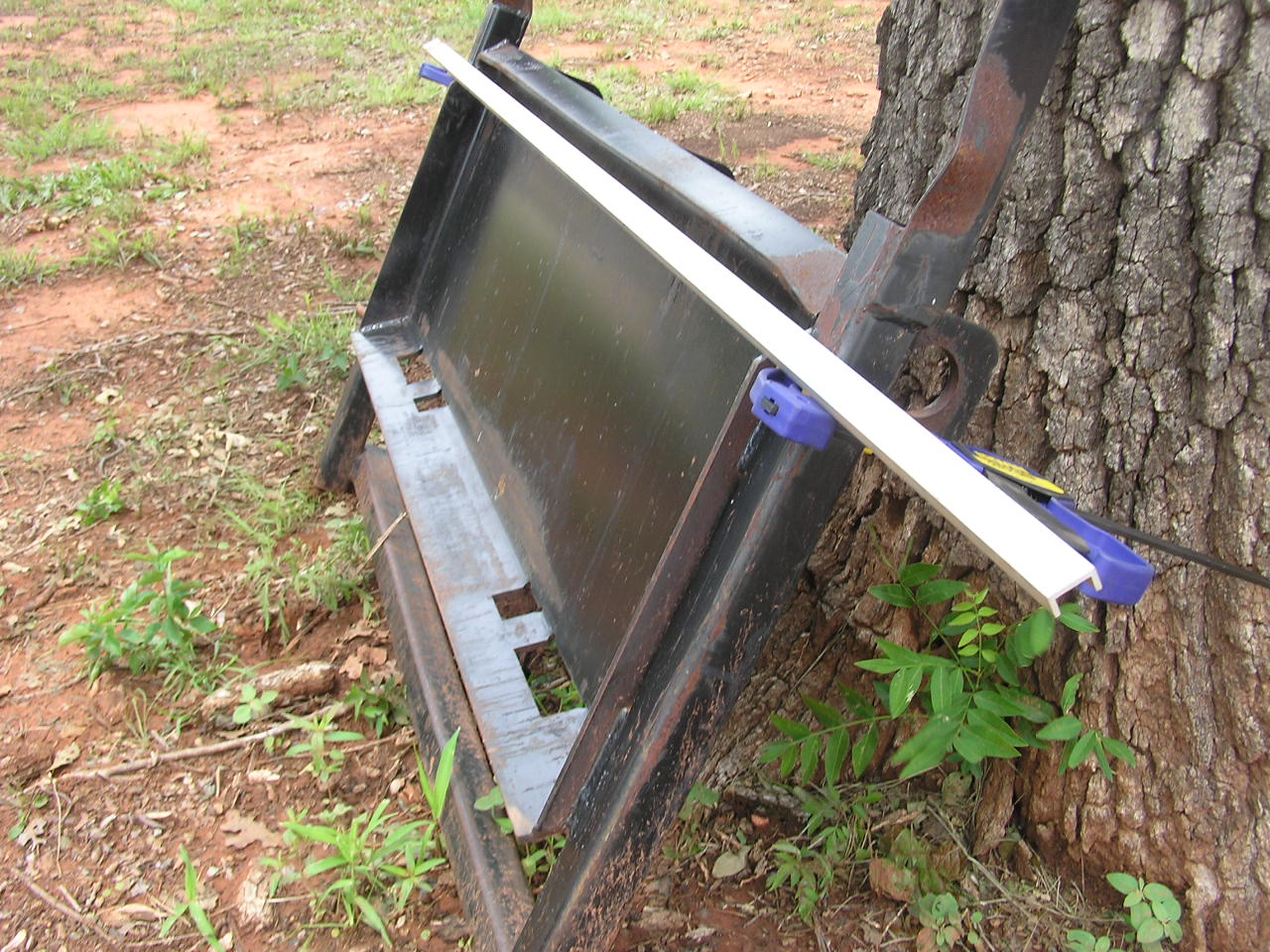

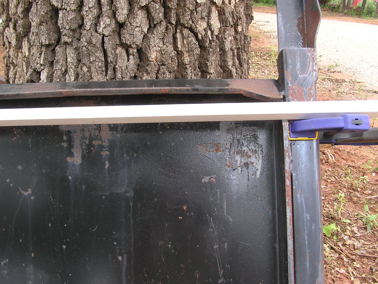

Not your fault. If the attachment plate is made right, there is no way it will come off, unless something bends or breaks.
I pulled this one loose at the bottom by putting too much down curl pressure on it. The plate is thin and the slots had stretched and worn over many years of use.
When it popped off, it bent the bottom plate at the latch pin slots.
On this light weight fork frame, it came off at the top when I picked up too much weight and it bent the 1/4" thick plate.
I put a straight edge on it so you can see where it bent. Also notice that it is too wide.
