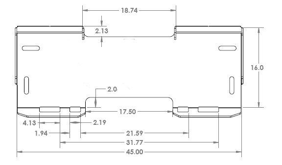

I bought a heavy-duty 60" Titan skid steer bucket. It is very heavy and robust.
The problem is that the SSQA portion of the bucket does NOT align with both SSQA pins on my Branson Tractor Loader.
The Branson tractor has had another 60" bucket and a 72" bucket on it with no alignment or connection issues.
I guess I will need to find a steel fab shop to rework the location of the hole(s) on the back of the bucket.
Has anyone else ever had a similar issue?
TIA
Yooper Dave
   / TITAN Skid Steer Bucket #2
It could be that Branson is not SSQA compatible or not to spec. I have Titan forks in SSQA and they fit as well as a home-built bucket with a SSQA back panel.
Here's the specs for the attachment panel.
   / TITAN Skid Steer Bucket #3
Seeing as though Bransons are SSQA, and he has had two OTHER buckets that are SSQA fit… I’d look at an issue with the Titan bucket itself. Is it one of their Chinese made products?
   / TITAN Skid Steer Bucket #4
I would guess that the error is on the Titan bucket.
The only attachment I have for my FEL other than the factory Branson bucket is an Artillian HD fork frame and set of forks. They fit my Branson SSQA mount without issue.
