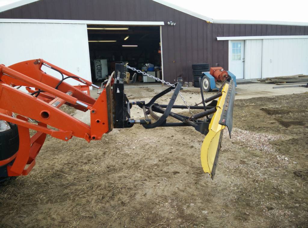

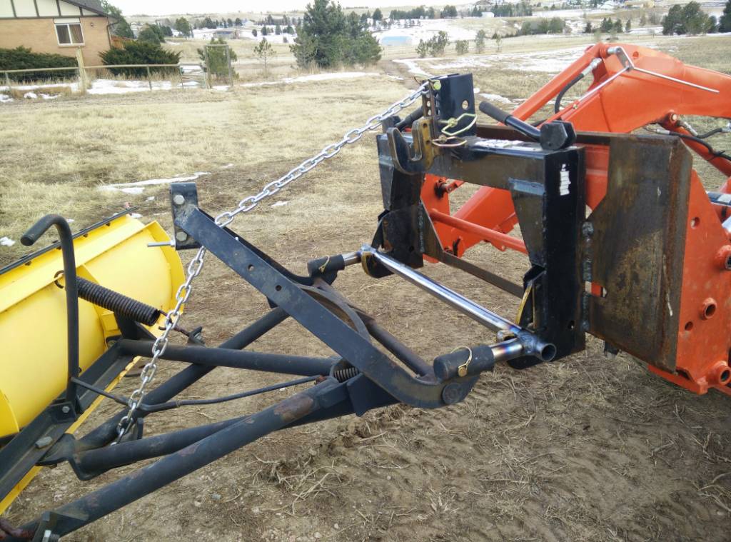

Not sure what adapter you are talking about precisely. I welded a Harbir Freight 3pt QH to a garage sale SSQA mounting plate. That made up most of the plow mount for my 32hp 3,000lbs L3200. It worked well more or less. No down pressure & I once curled/bounced the plow over the top. Also the whole setup hung out a ways. A more compact setup would be easier on the loader & let you steer better.

Why go through the extra 3 pt quick change. Shorten it up , mount the plow right to the ss plate. Just wondering

It was easy to design that way & I had the parts handy. At the time I built it I didnt realize compactness was as important as I do now. The QH adds 4" or so & the cross pipe bracket on the plow adds maybe 4-5" more.
It ran well, but the steering wheel wouldn't work when plowing unless you had chains on the front of the L3200. I sold the plow with the L3200 when I upgraded to the cabbed L4060.
The 3pt for the loader was handy for moving impliments. I've acquired parts to build another SSQA to 3pt QH adapter at garage sale prices. Havent welded it together yet though.
