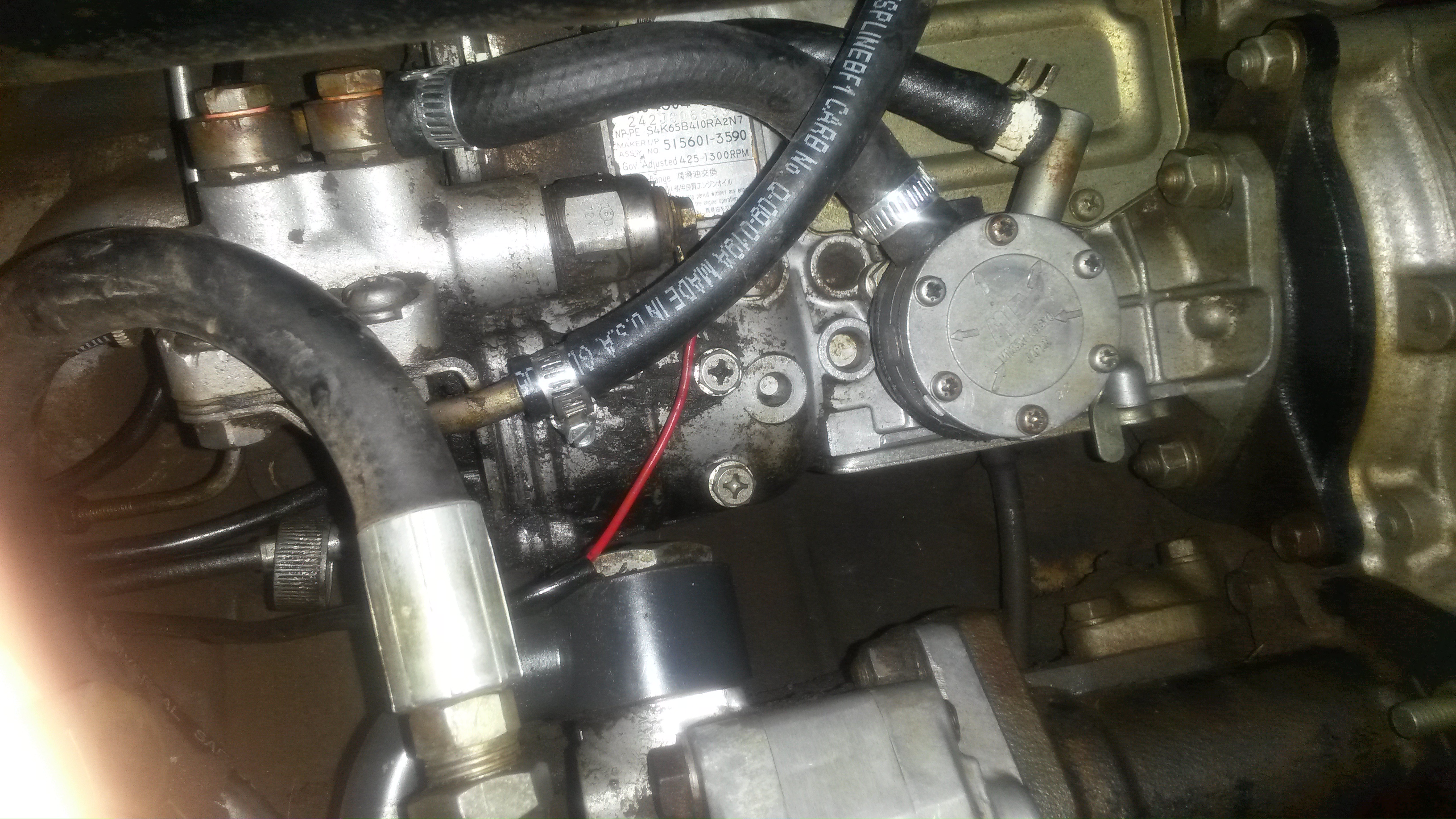

   / TL3200 ignition switch #4
Jason, I think you are talking about the round piece with six screws. I have attached a picture. This is the fuel lift pump and I am currently trying to find a replacement or to try and fix mine because I think it might be bad. I keep getting air into my fuel system and have replaced just about everything but this piece and I have read that if this piece is bad it can cause a vacuum and let air in your fuel system. I am going to to try and pressure test the fuel system first because after inspection of this piece it looks its like pain to try and get it off because there is little to no room to get to the nuts.
Yes, that's the one with the lever I was referring to. Is the other pump (knob is just visible under the big hose on the left side of your picture) a primer pump then? If so, how much travel is it supposed to have? Mine only moves around 1/8 - 3/16 inch with moderate force applied (it may move further, I just haven't wanted to pull too hard without knowing).

   / TL3200 ignition switch #7
Jason glad you got the tractor running again. I think you may be right in the solenoid being stuck open. About your previous questions you asked me in referring to the knob and the play it had in it but I am not sure what knob your you are referring to. I don't think there should be any play in the device your are referring to. I did check on my tractor and there is not anything in that area with play in it.
