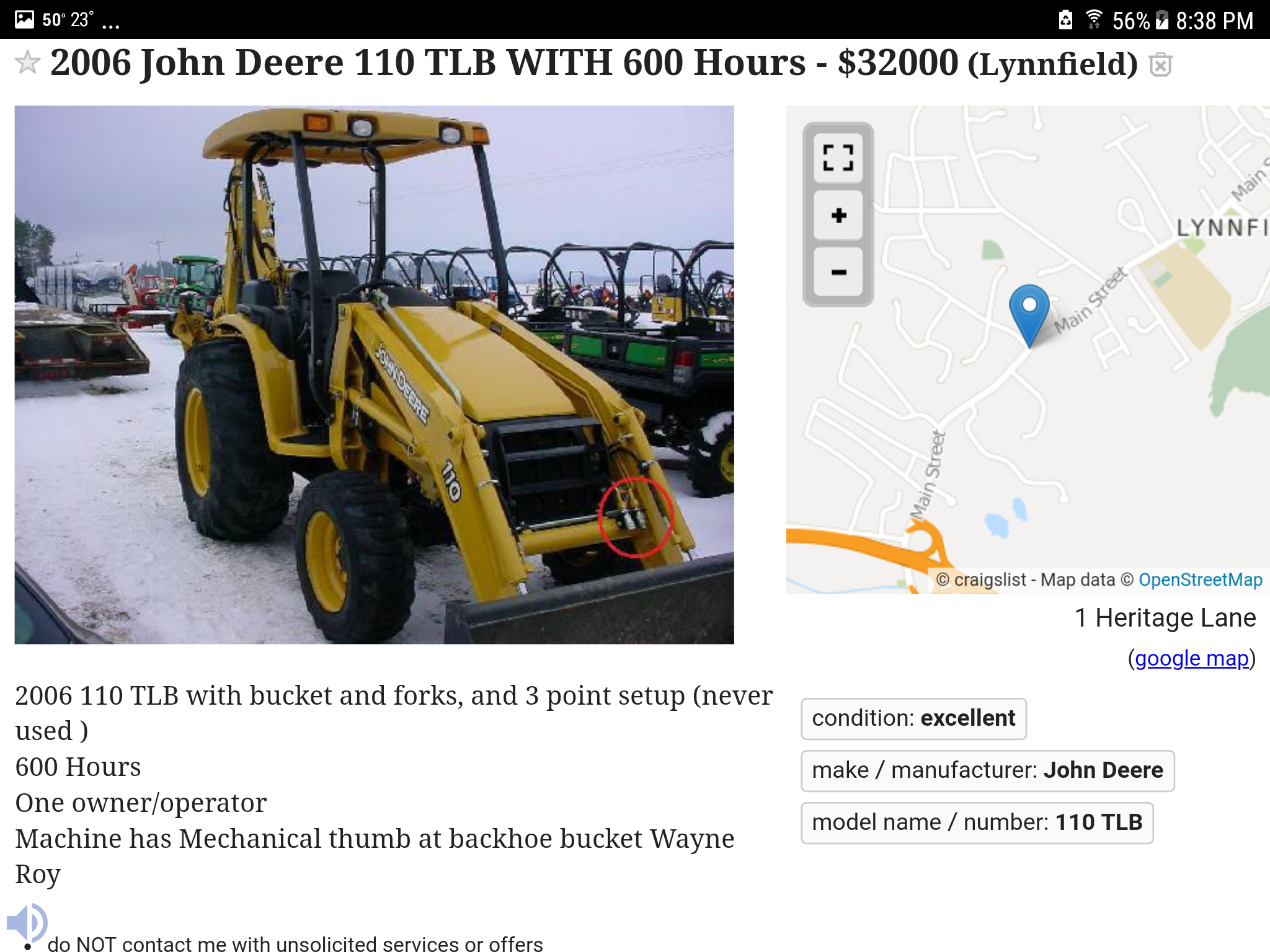

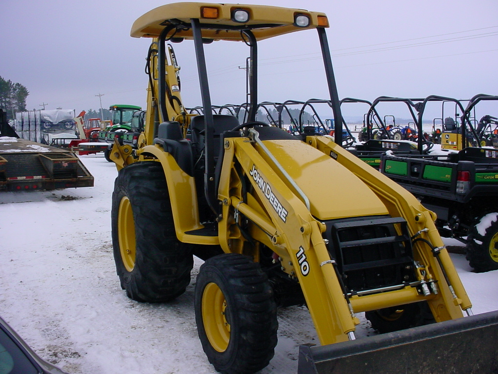

yep, I have no regrets buying my 110
My old Ferguson TO20 in the background
old thread here but I see someone is using your 110 as a fine example.
saw this while looking for a good used 110
26 John Deere 11 TLB WITH 6 Hours - heavy equipment - by owner - sale
/ TLB 110 #30
Thanks for the info.
That has to be the best looking 110 that I have seen
