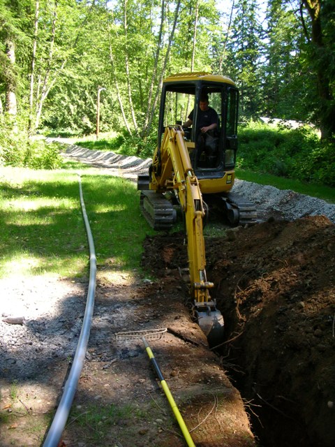

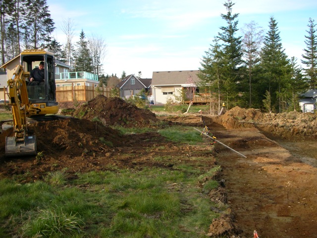

I have a 3720 with a cab and no backhoe and love the tractor,I had a 4400 TLB and the backhoe are so-so for that kind of work any think out 2.5 to 3 feet will be very slow,the prob. with TLB for that type of work is bucket size and not being able to swing 360 dergees like a mini x, I bought a 35 deere mini x and can out work a 3720/4400 TLB 4 to 1 in what i get done,my best day digging a 1' wide by 3' deep trench I did about 70' to 80' feet a hour on my mini x digging a 1' wide by 3' deep I did 250' to 270' feet a hour. so rent and try before you buy.
minimax
   / TLB 3520 or 4120??? #4
Here's a few pics of the mini x working.Try digging a hole like in the pic. with a TLB.
minimax

minimax, just out of curiousity. How come in the pic of the electric conduit run you are digging with your boom offset -the blade to the rear and not on the ground?
   / TLB 3520 or 4120??? #8
Well for a few reasons, the owner of the grass on the left did not want it tore up, and once I got to the trees I would not have the room to dig with thw boom in the center, Ilike to dig with the blade behind me if the ground is soft because you get a few more feet of dicth before you have move.
minimax
   / TLB 3520 or 4120??? #9
OK, that explains it. Was just curious. Thanks
