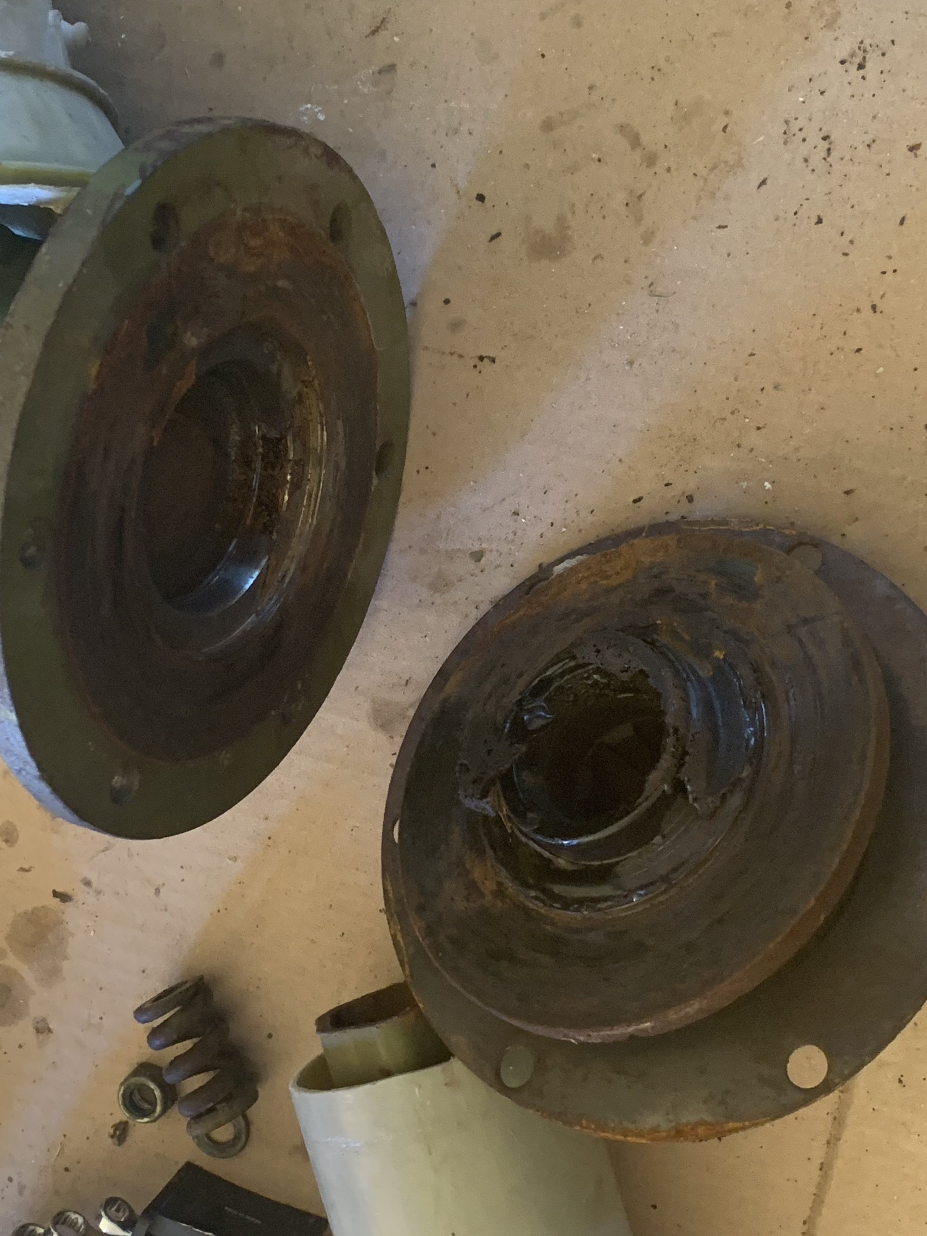

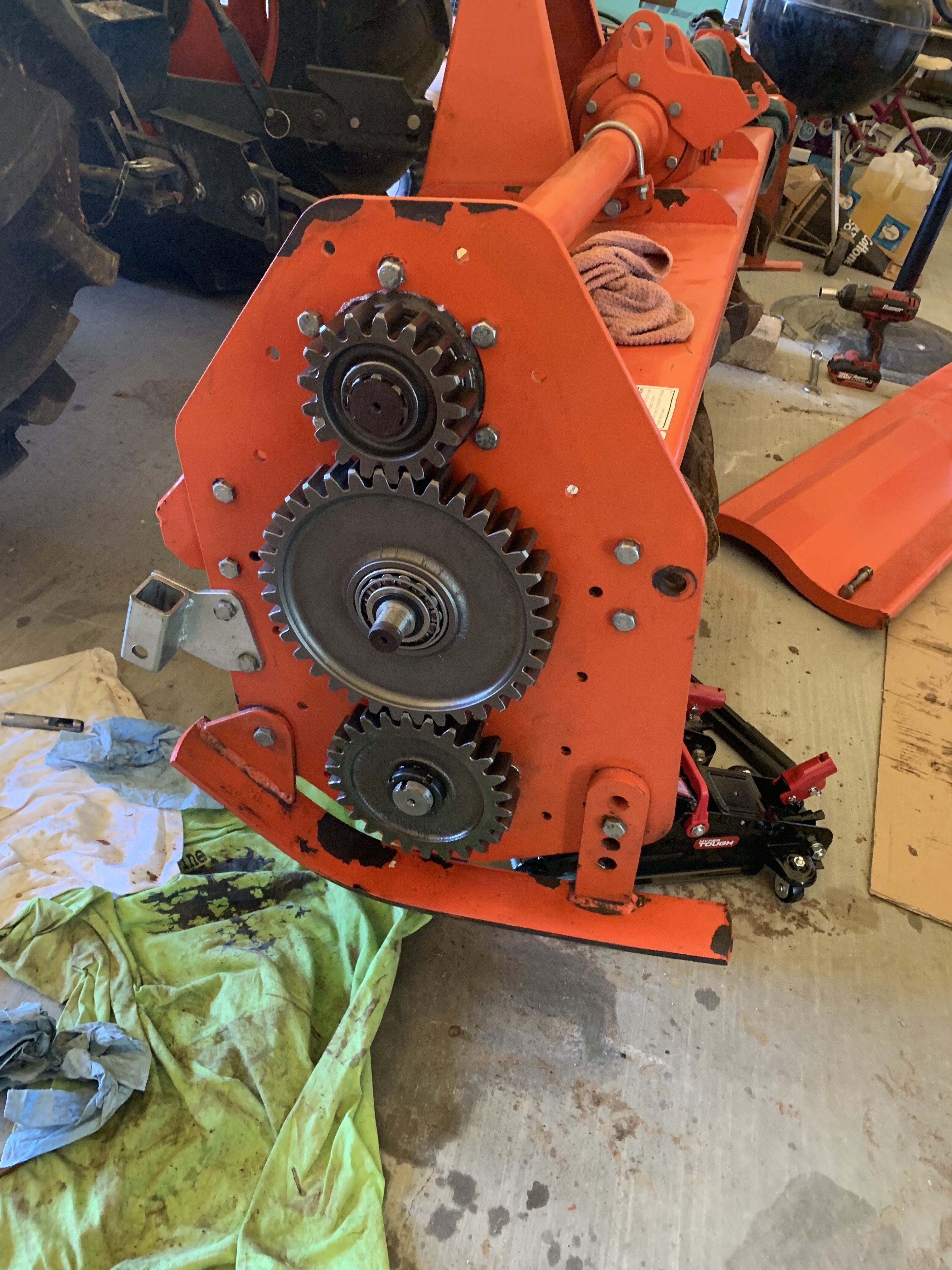

Got the seal job done. Here’s a couple of photos of the job. The project started out as maintenance on the slip clutch. It wound up doing a seal job on the gearbox and on the transmission. When I took apart, the slip clutch it was minus any clutch disc one seem to be melted. Are there any recommendations on the type of Friction disc to reinstall. They may all be basically the same so it may not matter, but I thought I’d ask. Anyhow, this is the last part to get this together. So word of advice when you buy used piece of equipment check all these things out particularly Lubrication issues and rotating parts.
