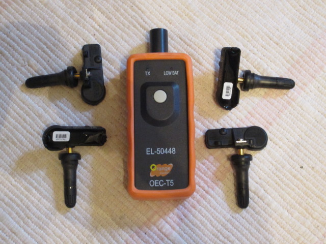

This is what your TPMS sensors should look like and my reset tool is in the center. TPMS 001_1.JPG

Battery life is 5 to 7 years or around 100k. For $40 you got the kit like I posted for each tire.
Be thankful on my car you cannot change the battery. So $150 for the sensor and $50 reprogramming fee. If I wait for each one to go separately it would be $50 for each reprogram.
When one battery goes the rest are not far off.
   / TMPS Battery #9
Just for kicks, search for "gm tpms" on ebay and check the prices. Like Clint said, replace all 4 sensors and unless they rotate the tire on the rim, you shouldn't need balancing. It takes about 2 min to reset the tpms with tool.
