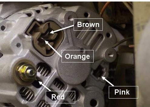

Joe, the red wire is your main power out of the alternator and should go over to the starter and then up to the main 40 amp fuse in the holder right above the starter. The brown wire to the alternator is the excitation wire. The orange wire is probably coming from Fuse #1 and is the voltage regulator sensing wire. When you turn on your key, you should feel 12v at that orange wire. For the brown wire: before you start your engine, power from fuse 4 or 5 goes positive to negative across the isolation diode, thru the alternator light and back to the alternator on the brown wire and to ground. When the alternator starts putting out power, the brown wire goes positive and therefore the potential across the light and the diode are the same from the fuse or the alternator, so the alternator light extinguishes. If you are not getting an alternator light on with the key on and the engine not running, something is wrong. It could be that the diode has opened.
The final wire off your alternator is pink. It is the tach input pulse stream to the tachometer in the instrument panel and is on a separate plug in the back of the alternator.
Here's a photo of your connections on the alternator showing the colors of wires and where they should be in case the wire colors have faded.

jim,,,,,,,,,, the alt. i have a denso if you was to look at mine from behind as yours youre pink is where my 16 ga red is your brown is where my hot (batt) is and where your red (batt ) is i have a black (grd).............but with what i found inside the module itself i will lay money that little ribbon of solder is causing the problem ............... this thing easly comes apart and if ya look close ya kin see has some keeerosion in spots of the ribbon solder mite be they sould had clear coat it ,,,, i am going to do a little testin with a stran a copper wire and paste it in what do i have to loose
   / tn 55 no dash lights,no charge #8
Joe, I apologize for leading you down the wrong path with info on a 40 amp alternator.:ashamed: I'm sure yours works similarly, but the wire colors and functions are certain to be different. Somehow, I read your "tn 55" as "TC 55" and just went off the deep end. It sounds like you have a handle on things despite my trying to lead you astray.:eek: I'll tuck my tail between my legs now and go sit in the corner. . .:(
