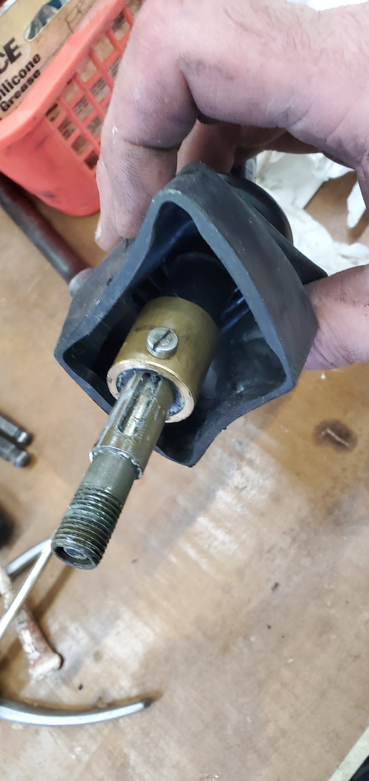

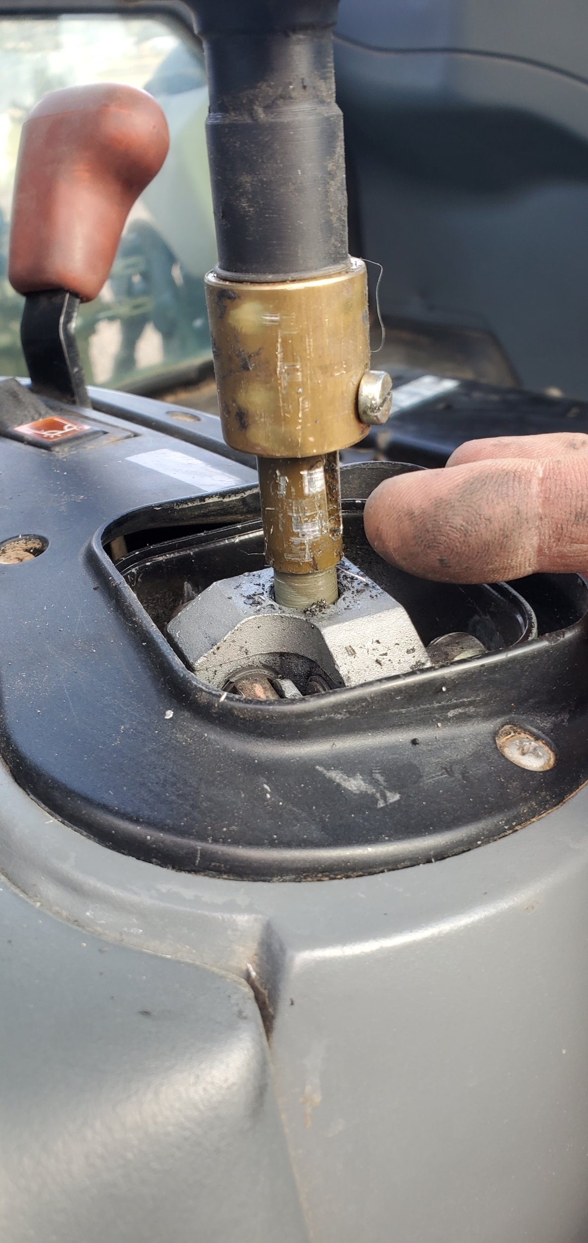

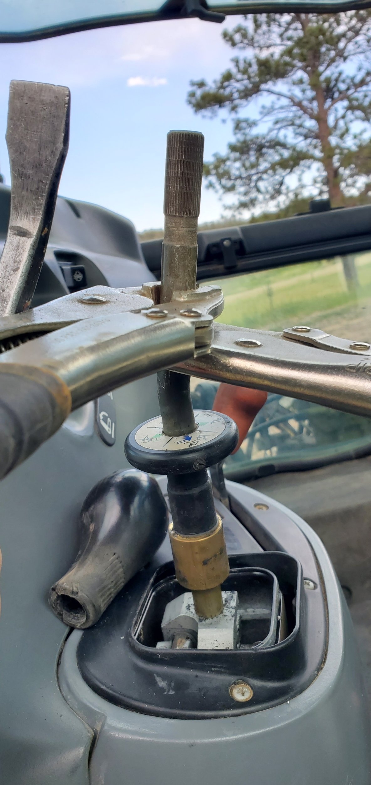

1. Joystick. To replace the boot do NOT try to take the knob/handle off. It's splined (pressed) on to the shaft. Will not help, as the sliding lock ring can't come off that direction anyhow. The joystick shaft is connected to the mechanism via threads and loctite (or similar thread locking compound). I used 2 Vise-grips to get it off. Had to clean up the new custom knurling. As the hand throttle knob is also pressed onto the throttle shaft, you can't take the 'console board' off. You take the Phillips screws out of the console and maneuver it enough to get the bottom of the boot over the joystick mechanism housing.
2. The joystick lock ring is attached to a sliding pin at the bottom of the joystick. When the ring is slid down the pin sticks out the bottom of the mechanism locking it up. Once you get the boot off you can see a slot head screw (decent sized) in the slot, and screwed into the pin (the screw is what the sliding lock ring acts on). When I reinstalled mine I used some green loctite (the weak stuff). I figured it was enough strength. If you tighten the screw too much it binds up on the shaft. I'm doing this from a week old memory, so fine details may be a little off. You get this far you'll see how it works.
