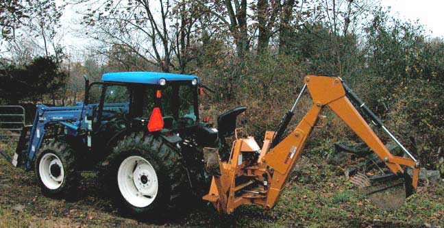

Question, is there a sub frame for any backhoe on a TN? I've never seen one. My woods 1050 is 3 pt and while I like to have a driver to move me around, not bad with ac and stereo /forums/images/graemlins/cool.gif I sometimes do move myself around... yes I know it's "dangerous" but where am I going to go if it's fairly level ground.

I paid $9000 for a Woods 1050 10 1/2 ' with a 24" bucket and another $600 for a 12" bucket. This is with a PTO pump and tank. I think the backhoe you're looking at is too small for a TN. But if it's ok for you I think the price is fine.
Andy

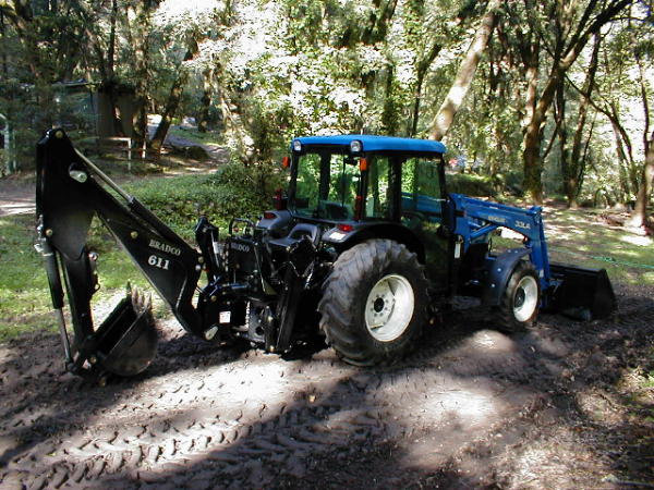

My TN has a subframe for the backhoe - and when I was ordering everything a while back (when I was originally getting a no-cab TN65), they told me that the subframe was the only way to go. Apparently the folks at Bradco said that they'd seen some problems on 3-pt mounted backhoes on the standard TN's. With a cab, I believe that a lot of the problem is minimized because the cab adds quite a bit of structural integrity. In hindsight, I somewhat wish that I got a 3-pt mounted backhoe - the subframe is pretty much permanently mounted and, while it makes the tractor strong as a tank, it eats up way too much ground clearance for my liking. I do a lot of driving into and out of very rocky ditches and creek-beds, and some of those rocks are as big as Volkswagens and I easily get hung up on them.
The NH 759C backhoe is pretty nice - the subframe stays with the backhoe when you remove the backhoe, and it's quite easy to install/remove. It's not the strongest backhoe in the world, but for medium-duty work, it's not bad.
Oh yeah, here's a picture of the Bradco 611 on my TN70S...
