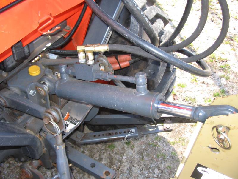

The check valves are available separately but the ones available here in the USA are bulky size wise and are rather expensive at over $50. Plus you have to plumb them in. It's cheaper in the long run to buy cylinders with the check valve already integrated. CCM has the best bang for the buck for top link and tilt link cylinders. They have many satisfied TBN customers.
Attached is a pic of my CCM top link cylinder.
