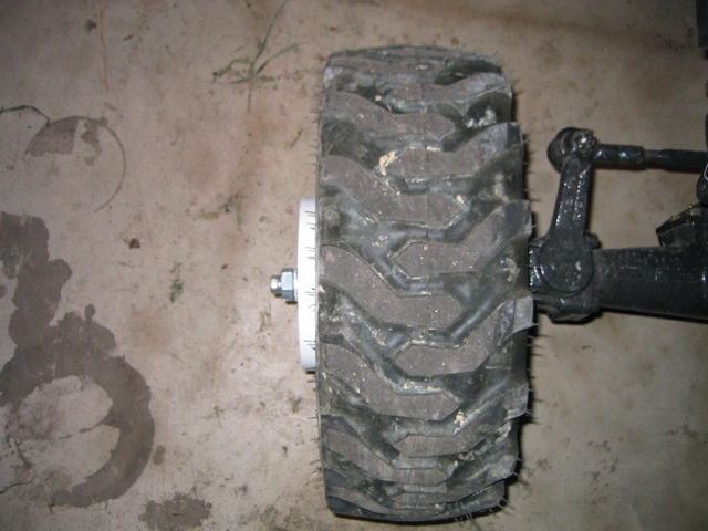

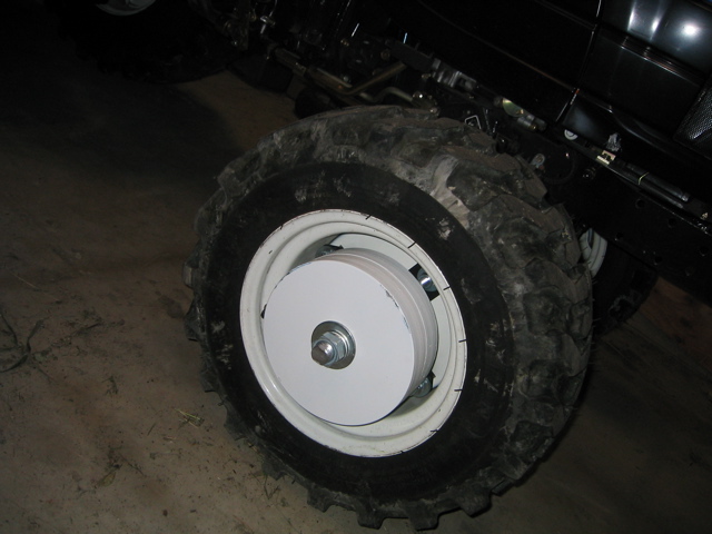

Are you looking for front weights for when the loader is not mounted?
I have a TC24 which is about the same size as the CK20. I put on some wheel weights made out of 9" steel bar stock. The stock was used to slice the stock into 4 weights, each weighing just over 25# apiece. Drilled a hole in the center of them and mounted them on the front wheels using a threaded 1" rod. They are easy to mount when needed, come off in a snap when not needed. They only extend about 2" beyond the rim so they don't get in the way. Adding 100# to the front at such a low point helps keep the tires on the ground when hauling some heavy implement on the rear (especially when climbing steep hills).
