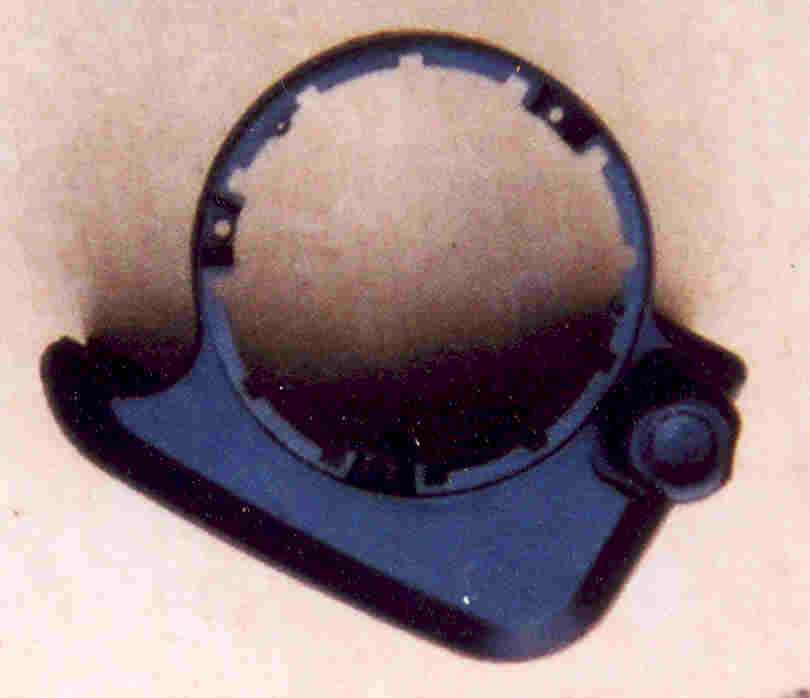

So here is the question. I now own two tanks. The old one I clearly abused /forums/images/graemlins/confused.gif and the brand new one.
So the attached picture is which one? The old or the new?
Fred

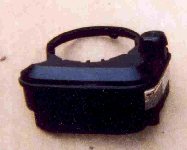

Here is a second picture.
Can you guess? are these pictures the old one or the new one?
Fred
