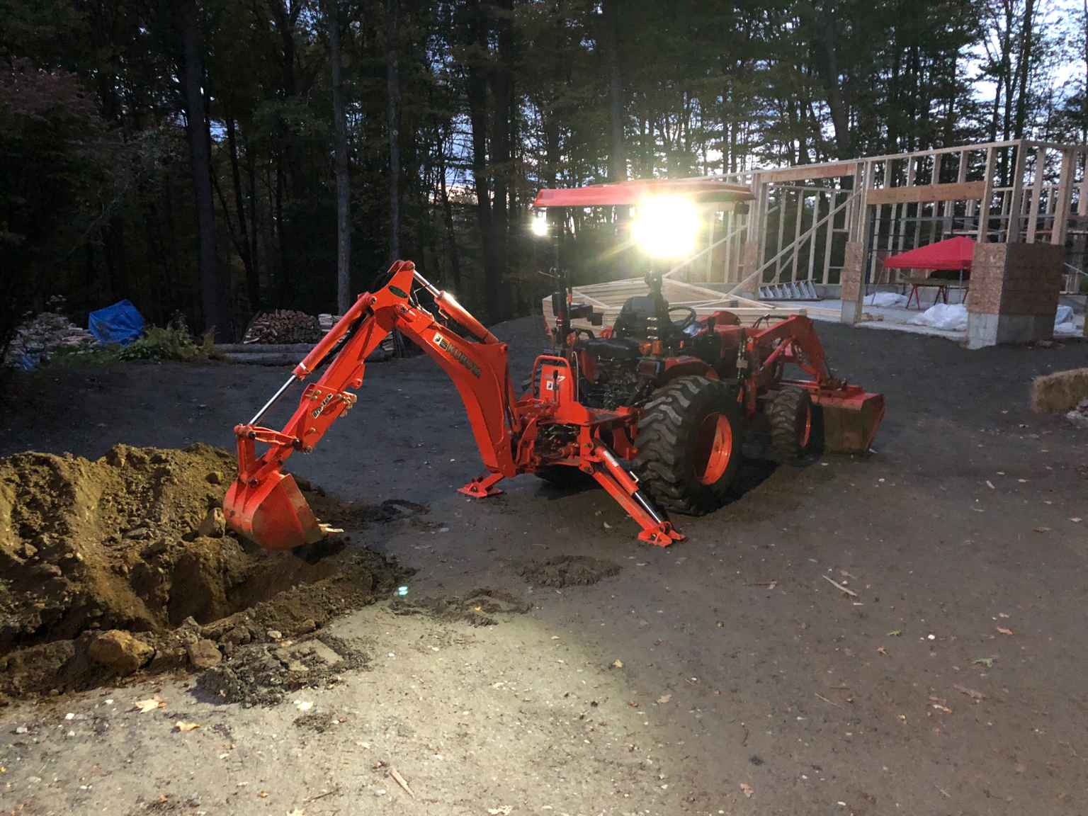

Started trenching for my electrical conduit for my barn project! Got to use the new lights & canopy I got from Thunderbird! They worked great! Plowing will be excellent this winter with the front facing ones! IMG_5551.JPG

Lou, can you explain whatever attachment is on the front of your tractor please. Did you make that?
Canuck, that looks both exciting and rewarding to get to this point. Keep going, snow's coming!
