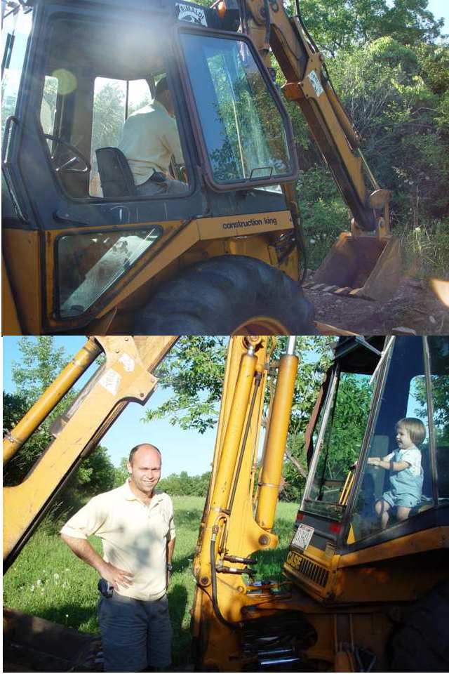

I want to first say thank you to all on this board who have been so helpful to me in my purchase / configuration over the past month and a half. After going through many configurations including a backhoe attach, looking at Deeres and Kubotas as well, I have placed my order for the TC40D.
I scrapped the backhoe attachment and went out and purchased a used Case 580D with an extendahoe. Quite a serious unit, and is sure to deliver many fun seat hours for her new owner. I have attached a picture (since I know I always love seeing the pictures of others! /forums/images/graemlins/smile.gif) That is my 2-yr old daughter in the seat (and yes, no keys in the machine at the time and all hydraulic pressure out of system at time of picture).
I will be getting my TC40D with no bucket as I was able to pick up a bobcat 4n1 cheaper separately. I did have them plumb the machine with an electric over hydraulic front Fasse valve for the front end implements.
