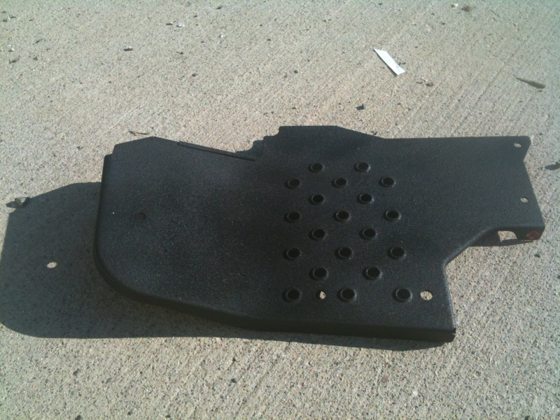

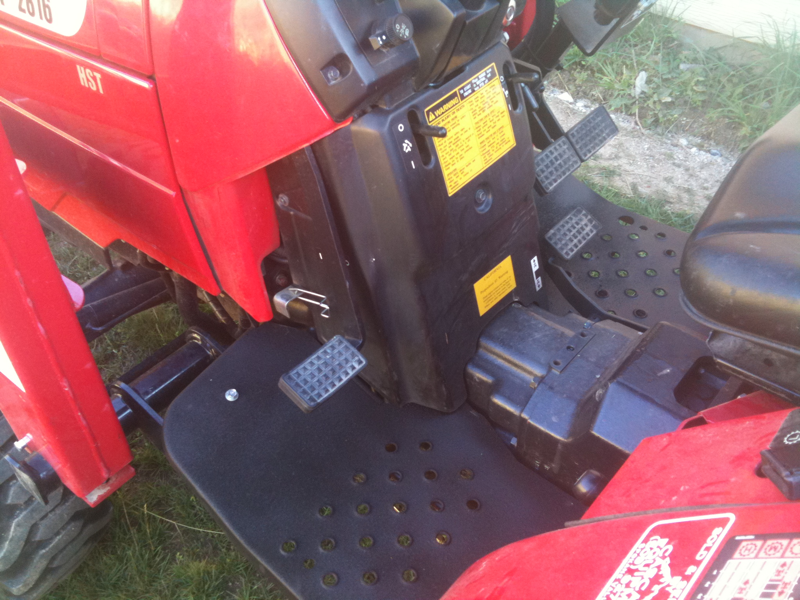

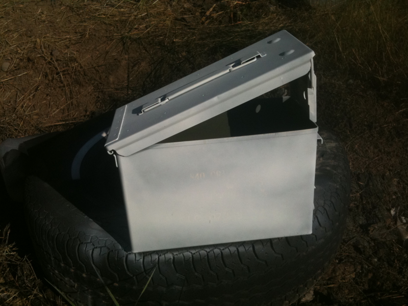

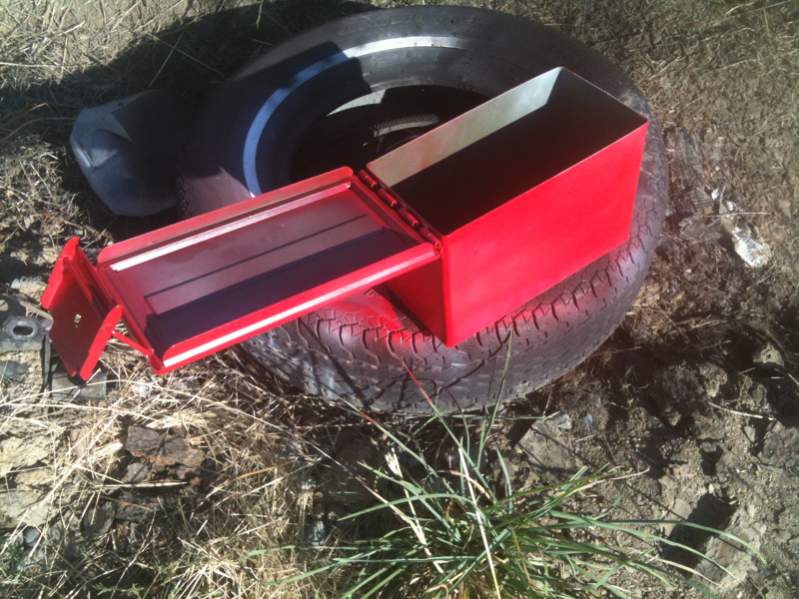

Got tired of slipping on my footwells every time I had wet boots. Also the paint was wearing off in several places and started to look bad.
My fix was some of that 3M rubberized underbody coating. Removed both footwells and put a few coats of that onto them. No more slips!
Also they had a stack of old ammo boxes at the store. Lil sanding and some paint. Few holes drilled and I have a waterproof toolbox.
It can fit some tools vs the stock toolbox that couldn't even hold a wrench.
Figured I would do something since we had to come home from camping early as the wife & kiddo were not felling well.
Let me know what you guys think.

Where are you going to mount the tool box?
   / Toolbox & footwell mod on 2816
Same location. Just too dark to take a picture now.

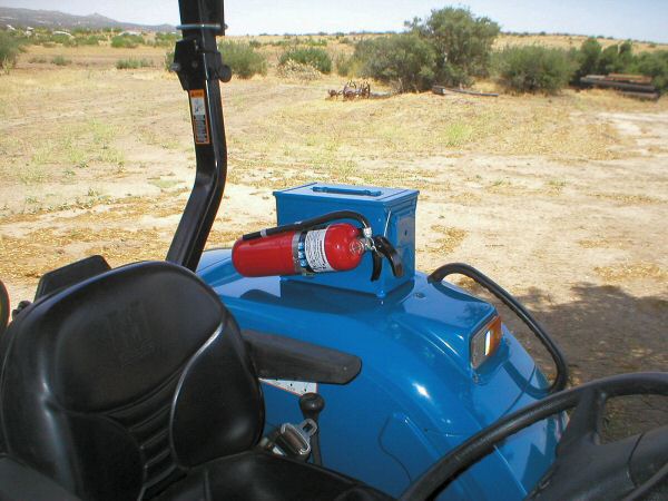

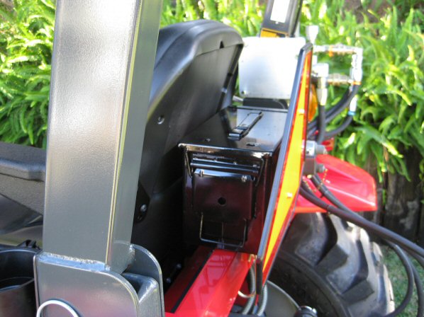

I like what you did to the foot wells. :thumbsup: Before I mounted my ammo boxes on my tractors, I lined them with 1/4" plywood to prevent dents and rattling. They have worked out very well for me.
