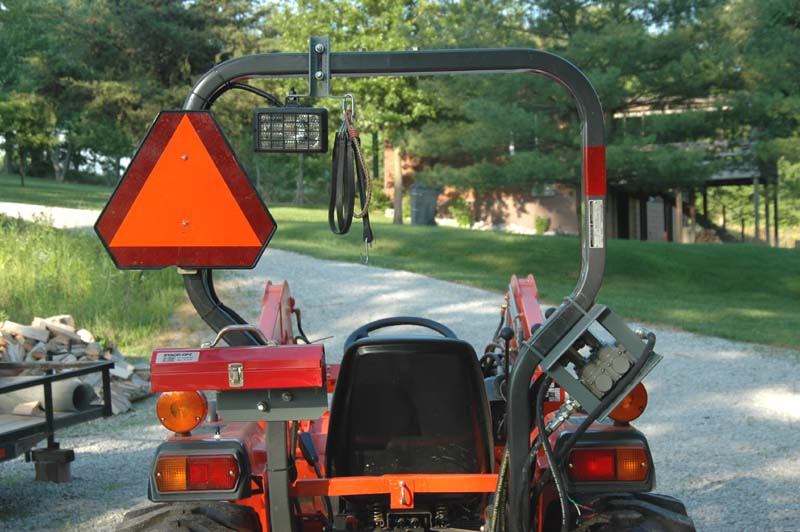

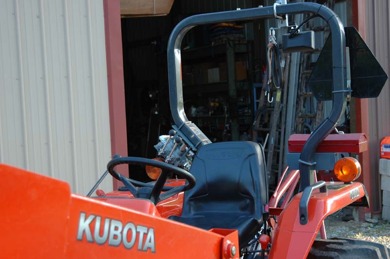

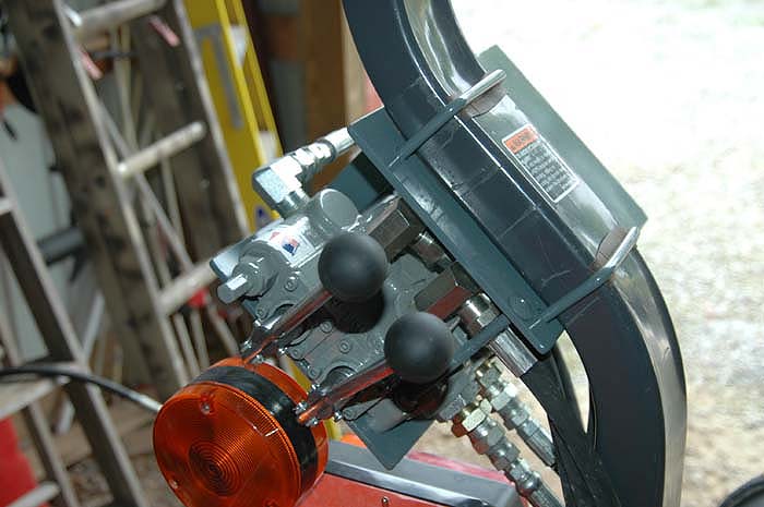

This thread should probably be entitled 'in praise of the square U-bolt'. With school out, I had some downtime, so have been accessorizing the L3400. I've seen several posts on where/how to mount brackets for a toolbox and for the valve for hydraulic remotes, so thought I'd share mine. Both are attached to the ROPS via square U-bolts. Others on TBN have mounted the hydraulic valve similarly, but on top of the ROPS frame. I like the levers closer to my hands, so I simply modified their ideas by offsetting the mount below the frame by 6 inches.
In the last picture, note I also used square U-bolts to move the SMV sign up out of the way of my boom pole and post hole digger, and to mount a rear worklight. Hope this helps if you're looking to do something similar.

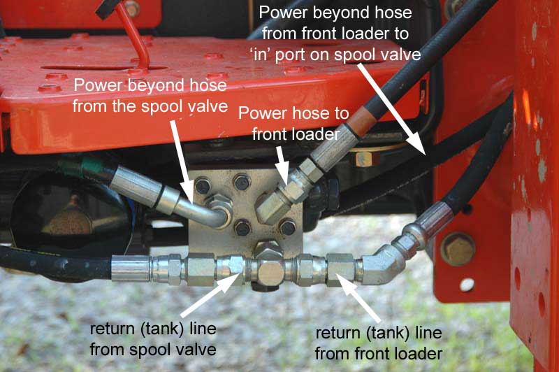

I am considering a project using rear remotes and I was just curious where you connected the spool valve to.
I just have not had time to investigate the rear remotes etc...
thanks,
Jim
   / Toolbox, Hyd valve brackets on L2800/L3400
thanks,
Jim
I think this is what you wanted. If you don't have a front loader, you'll have to buy the block to which all these hoses connect.
Mike
   / Toolbox, Hyd valve brackets on L2800/L3400 #6
that is exactly what I was looking for...
I want to do a root grapple or a pair of fingers for the bucket..
got alot of brush to move....
If I work it right, I might be able to put in a hyd top link too...
THANKS!!!
Jim
