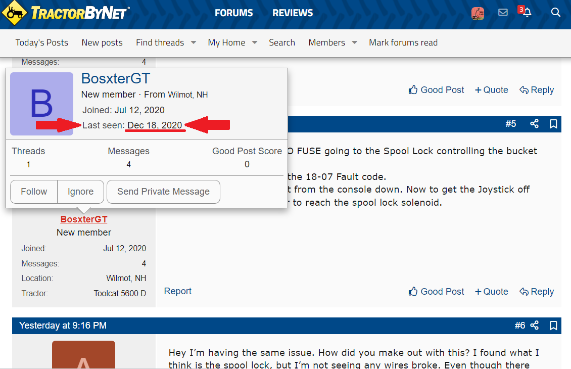

Hey I’m having the same issue. How did you make out with this? I found what I think is the spool lock, but I’m not seeing any wires broke. Even though there was a mouse nest I pulled out of there. Wondering where you had a broken wire or how you fixed this. Thanks
   / Toolcat 5600 D Error code 18-07 Spool Lock Open #7
What series is your Toolcat?
Might not hear from BosxterGT:
Maybe someone else will respond.
