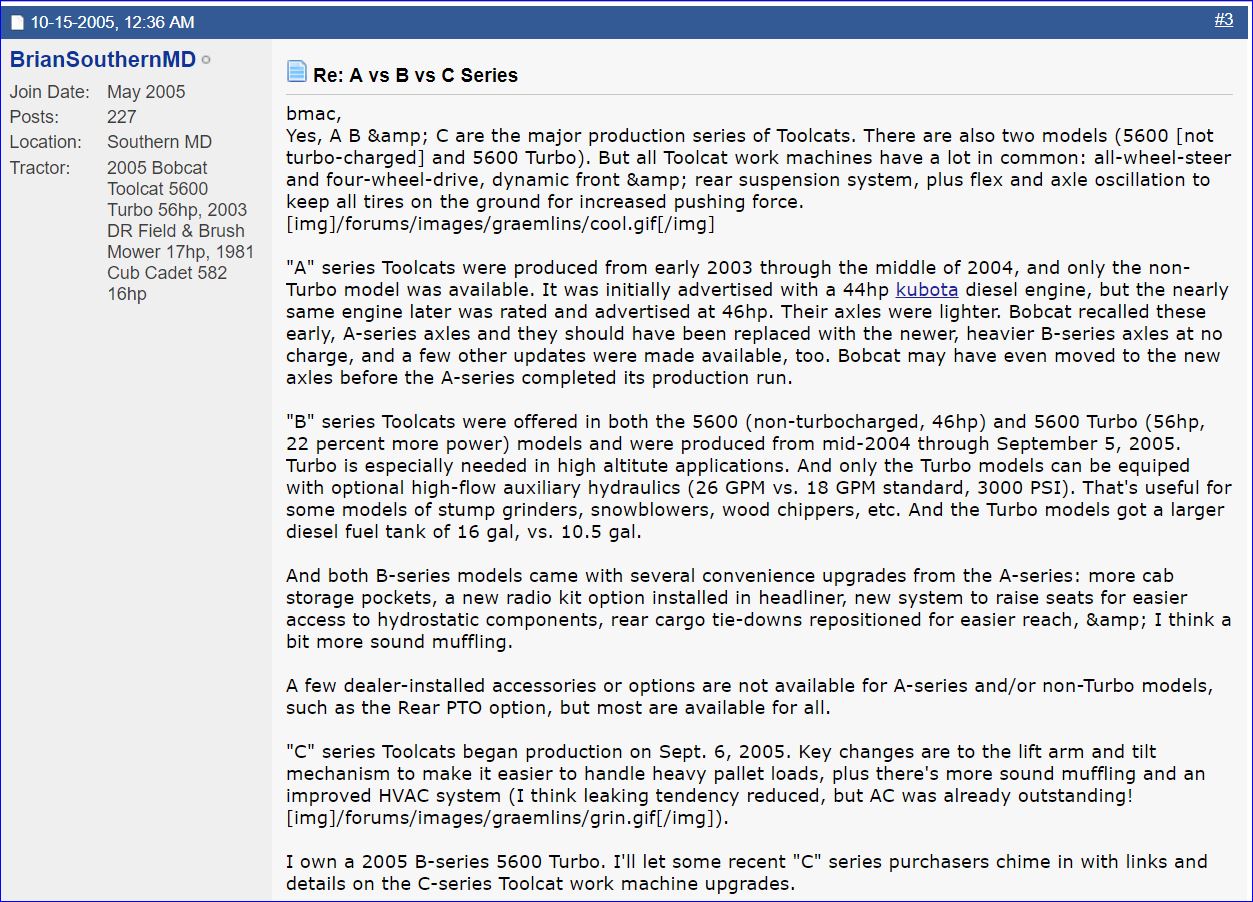

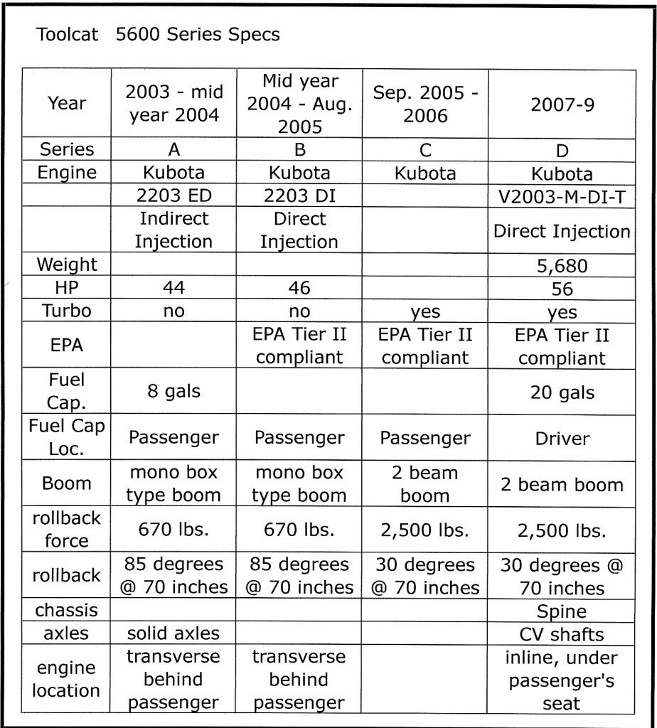

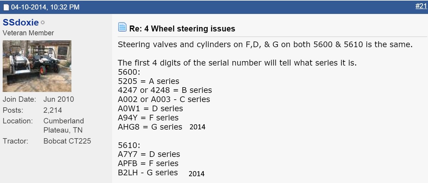

The serial number shows to be an A series.
Here are some snips from the past:
