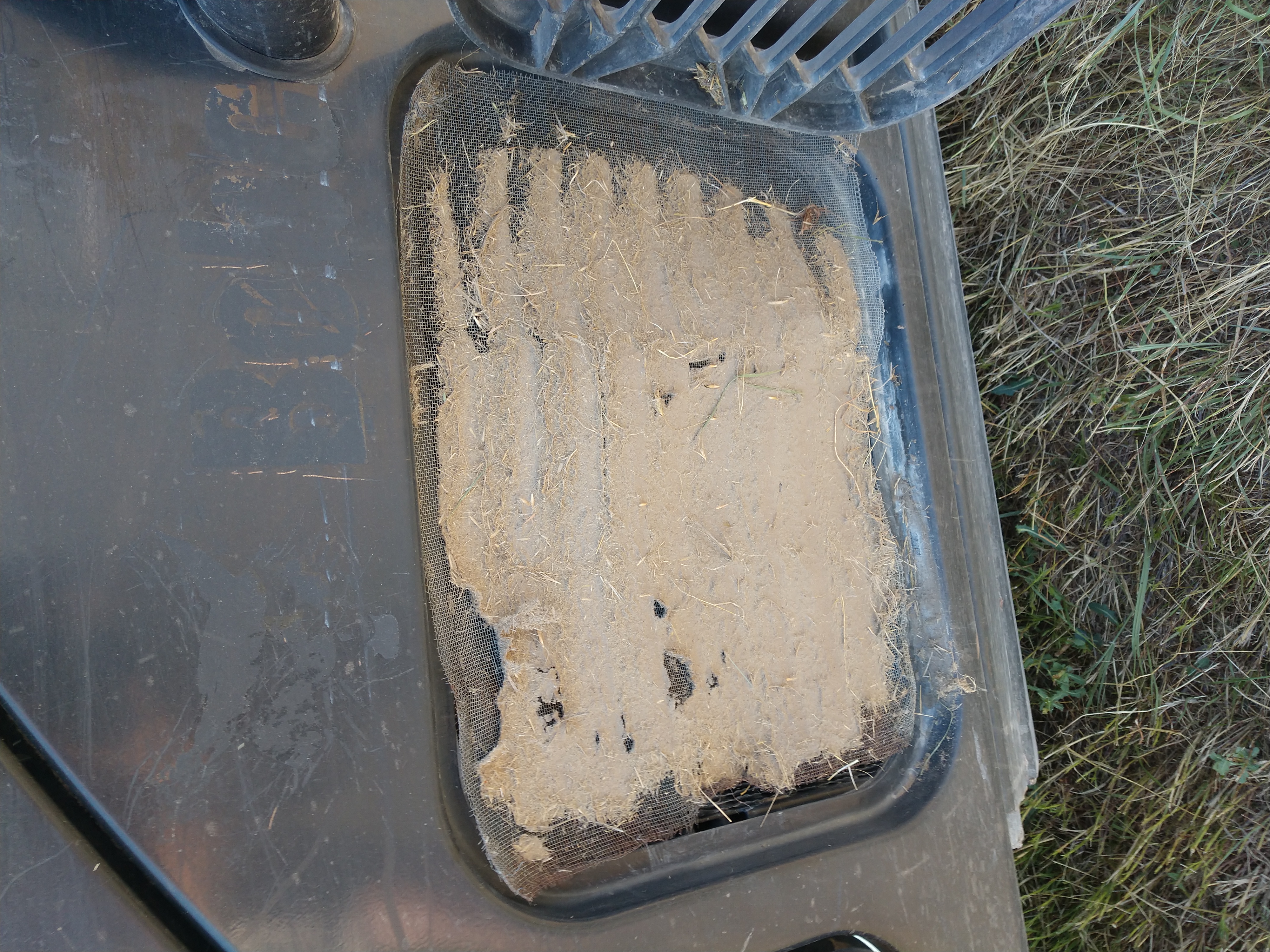

I never have liked where the AC condenser is located on the Toolcats. I mow a lot with my 5610 and in no time my condenser was plugged to where I had to remove these air cleaner and fan an a few hours of washing and blowing it out. My "fix" was to put a piece of window screen in front of the condenser. Now when AC starts cooling poorly, I'll switch it off, open the access door and take the screen out and knock it off. AC works great again. Occasionally blow out the condenser but it hasn't been plugged since putting the screen on. The closed door just holdsd thhe scrwewern in place. The screen will. Ioften be poluggeed in under an hour. I also put on the air intake extension from Bobcat. Before my air filter would be plugged solid in no time when mowing. Picture is after about 45 minutes of mowing. Without the screen, most of fines would be plugged in the condenser.

I wouldn't call this a bad solution,is just making the best of a bad desighn. Window screen covering a radiator or condenser drasticly inhibit's flow of air so should be avoided if possible. I'm not guessing at this or repeating what "Mr I Herd and Mr Tha Sayed" told me. You can see this for yourself while checking or recharging an air conditioner (tractor, car or home). Cover intake with screen and watch head pressure increase. Once again,what you are doing is better than doing nothing at all. Condensers should be mounted on cab but still require's diligence with maintenance.

Just making fix to poor design. I'm aware the screen isn't the best but it beats completed plugging the condenser weekly. To get it really cleaned out,I had to pull air cleaner box and fan to clean it from both sides. After a few mowings AC would barely work at all.

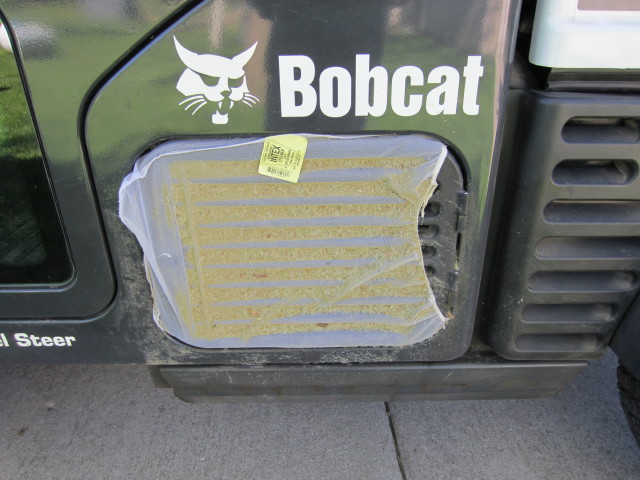

Bobcat has a side screen kit (7199661) that does about the same thing. I have a supply of paint filters that are the 5 gallon size, that fits the side door perfectly. After mowing, I shut the AC off and shake off the filter.
