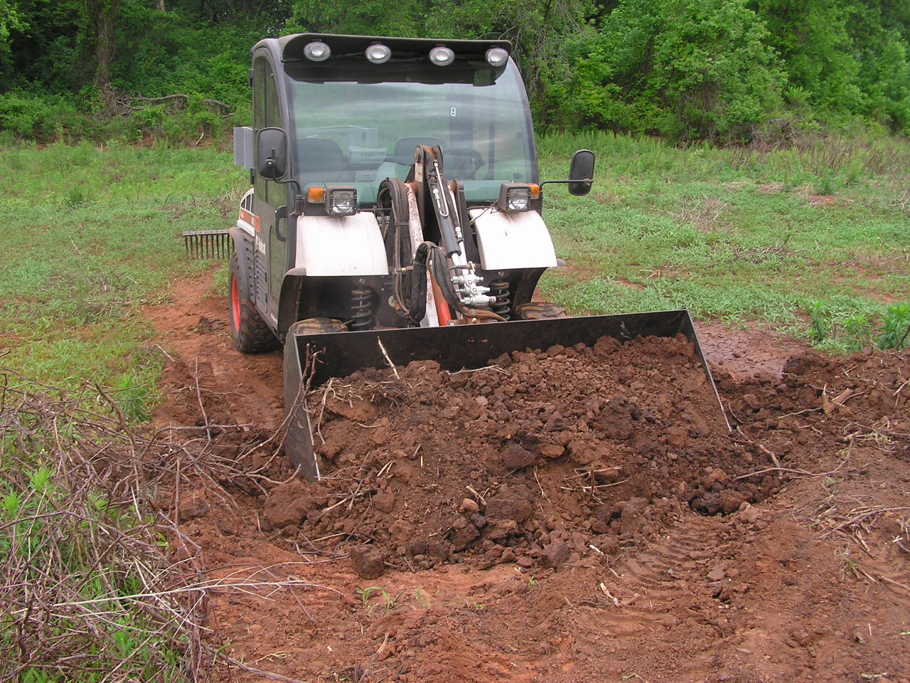

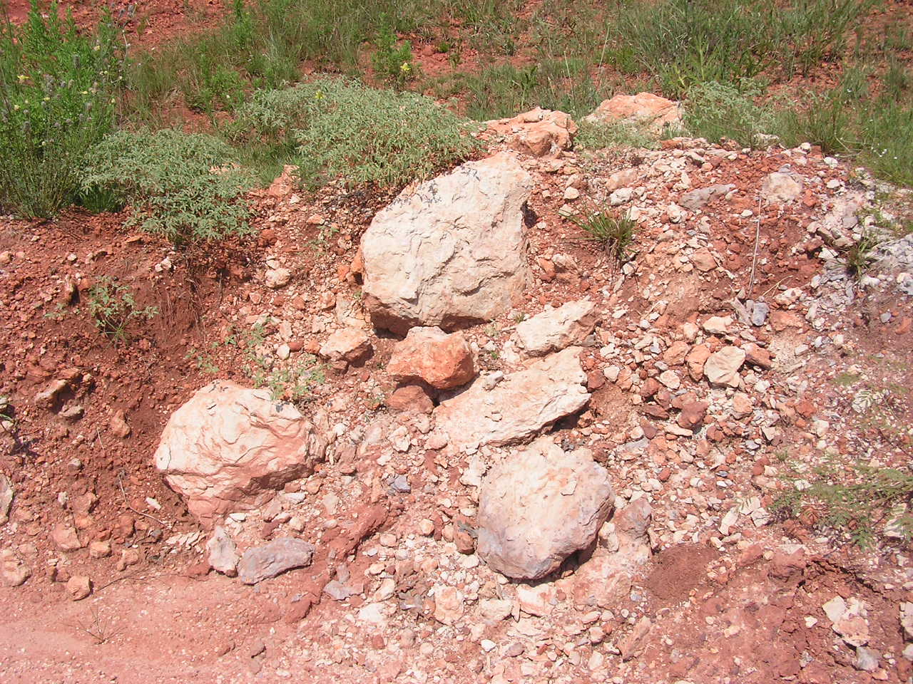

No problems with dust when mowing or moving dirt.
Our problem is that mice got in the cab over the winter, while not being used.
