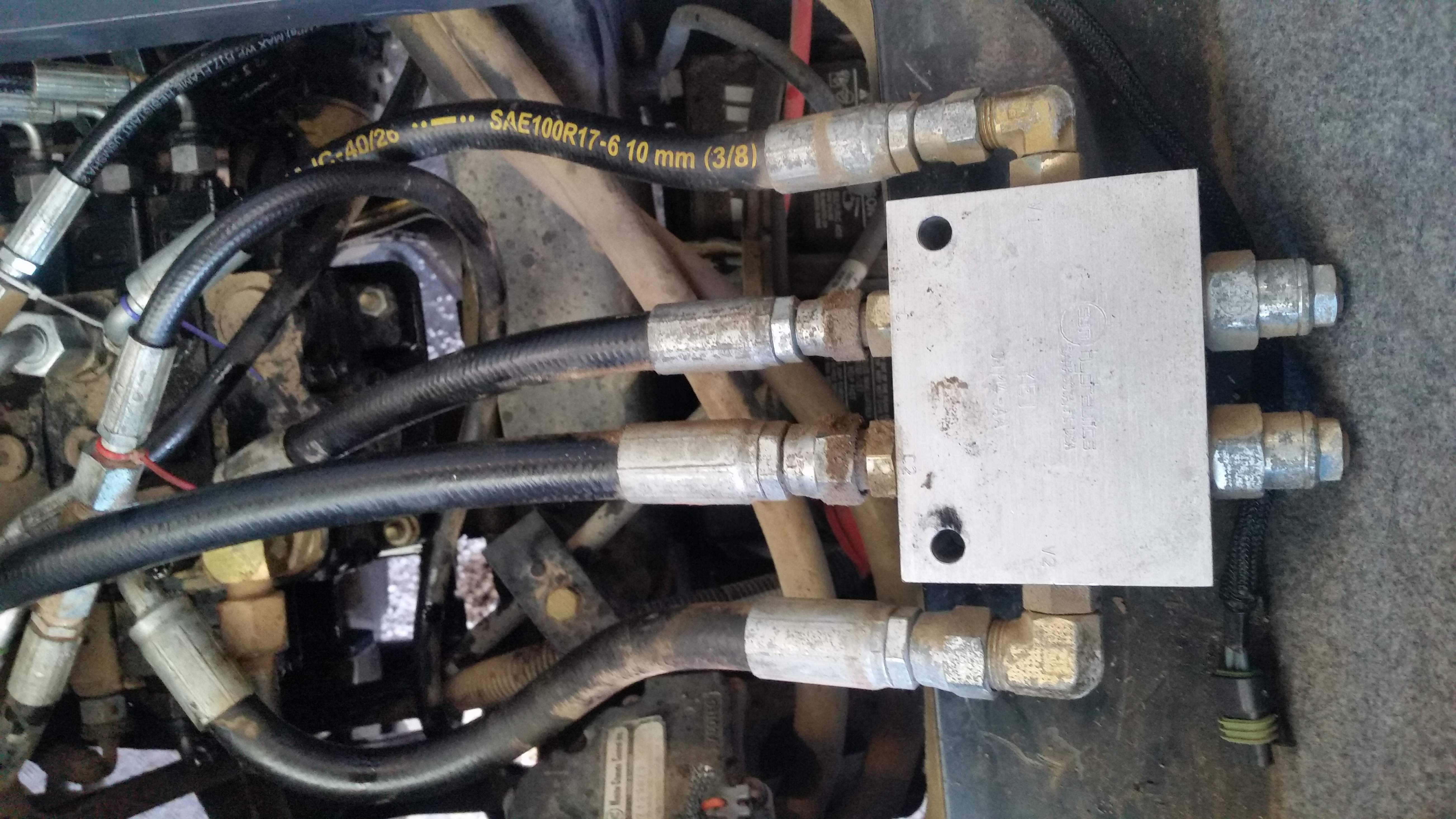

Hi All, first post and very excited to read all of the posts and knowledge being shared! :thumbsup: I can't seem to get the float feature to work on a 2007 5600C. I push the joystick forward until it sets into place, I have tried pushing the trigger button after setting the joystick, nothing.. I even loaded the bucket with dirt and tried to float, it just stays in position.
What is the correct procedure? Is there a solonoid or valve I can inspect? The dealer tore this unit down and flushed all lines after the drive motors went out on it.
Thanks!

If the joystick stays forward it is in float. On my 5610F, I hear a solenoid pull in and the boom will drop.

I have a D series, not a C series but pushing the joystick all the way forward until it locks, allows the boom to float. Curling the bucket works normally (side-to-side) in the float position.

As it turns out, the closest Bobcat dealer is fortunate enough to have a Really good service manager. After pulling the spool valve for the lift boom apart a few times, attention got turned to this block piped in between the spool valve bank and the lift cylinder. It was put there by the drilling company that originally ordered the toolcat. The block prevented the boom from leaking down, and floating.
Thank you for your input, I am posting pics of my new backdrag blade next..
