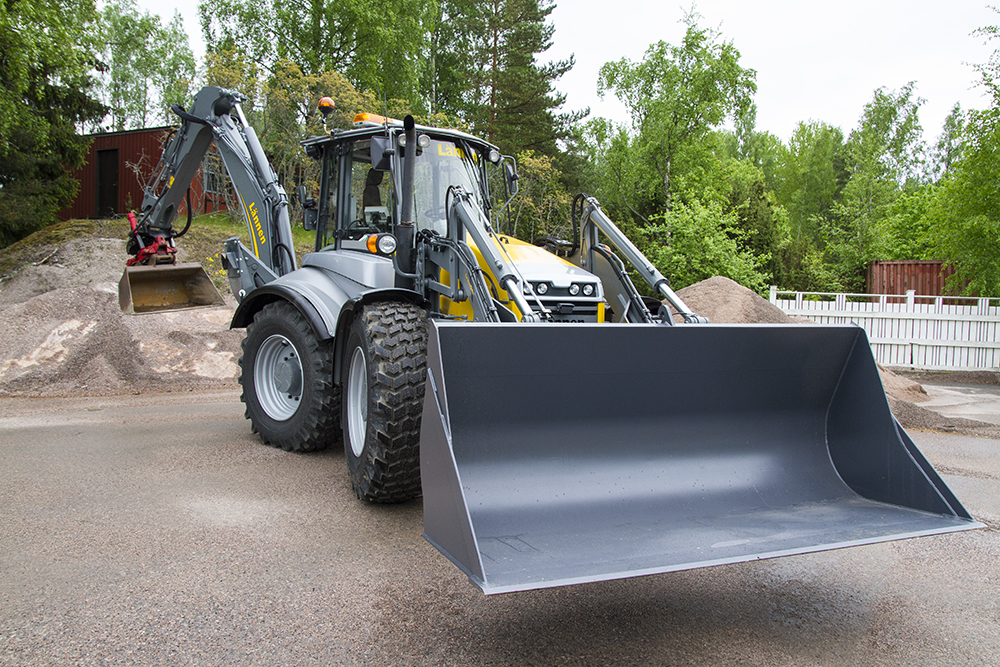

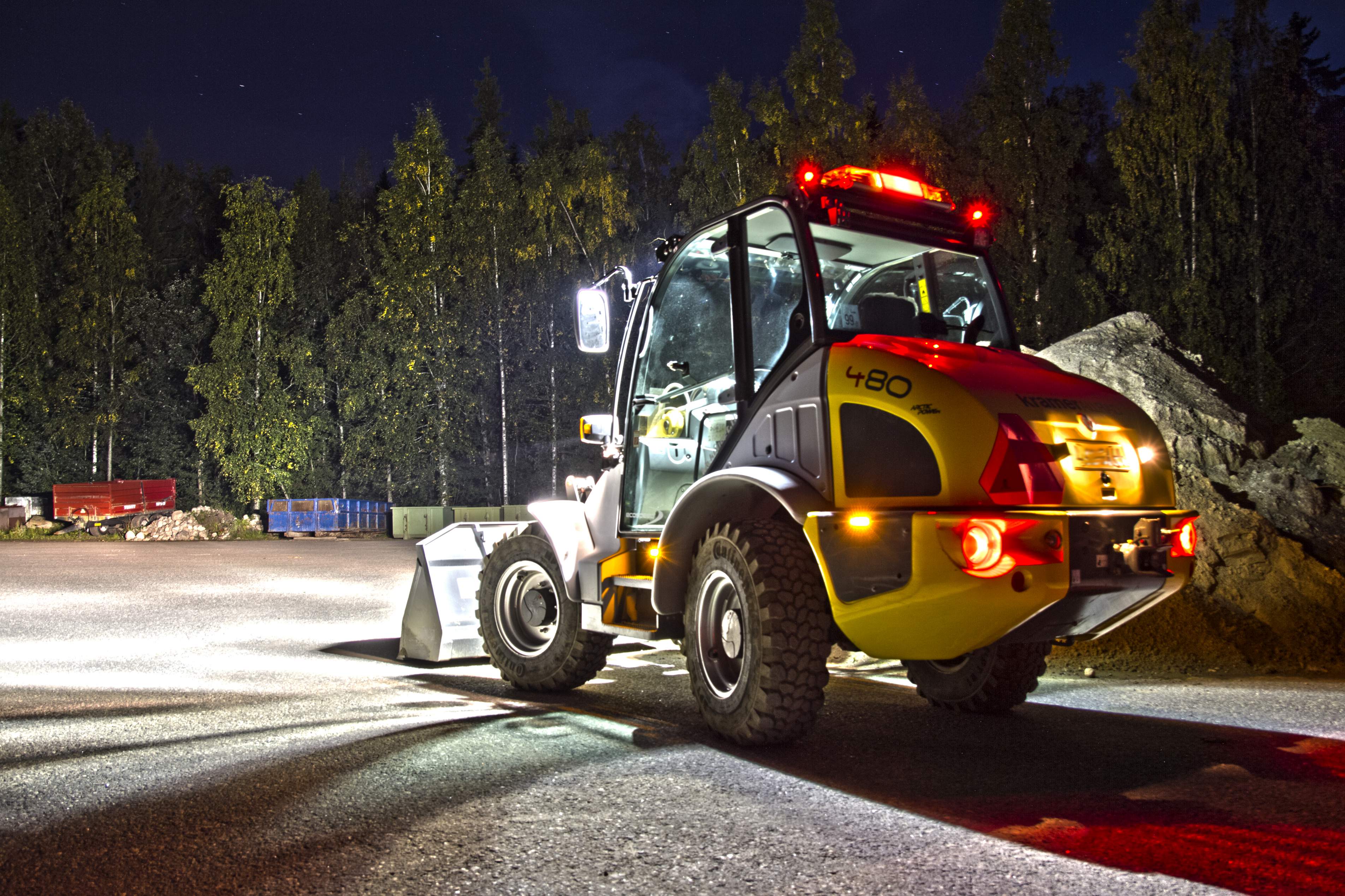

Here is an example what we did for one of our other machine(night shot). The next pic is our Lannen 8600g backhoe, I put it because I don't know have you seen this kind of machines. I have to say that i love it :licking: !

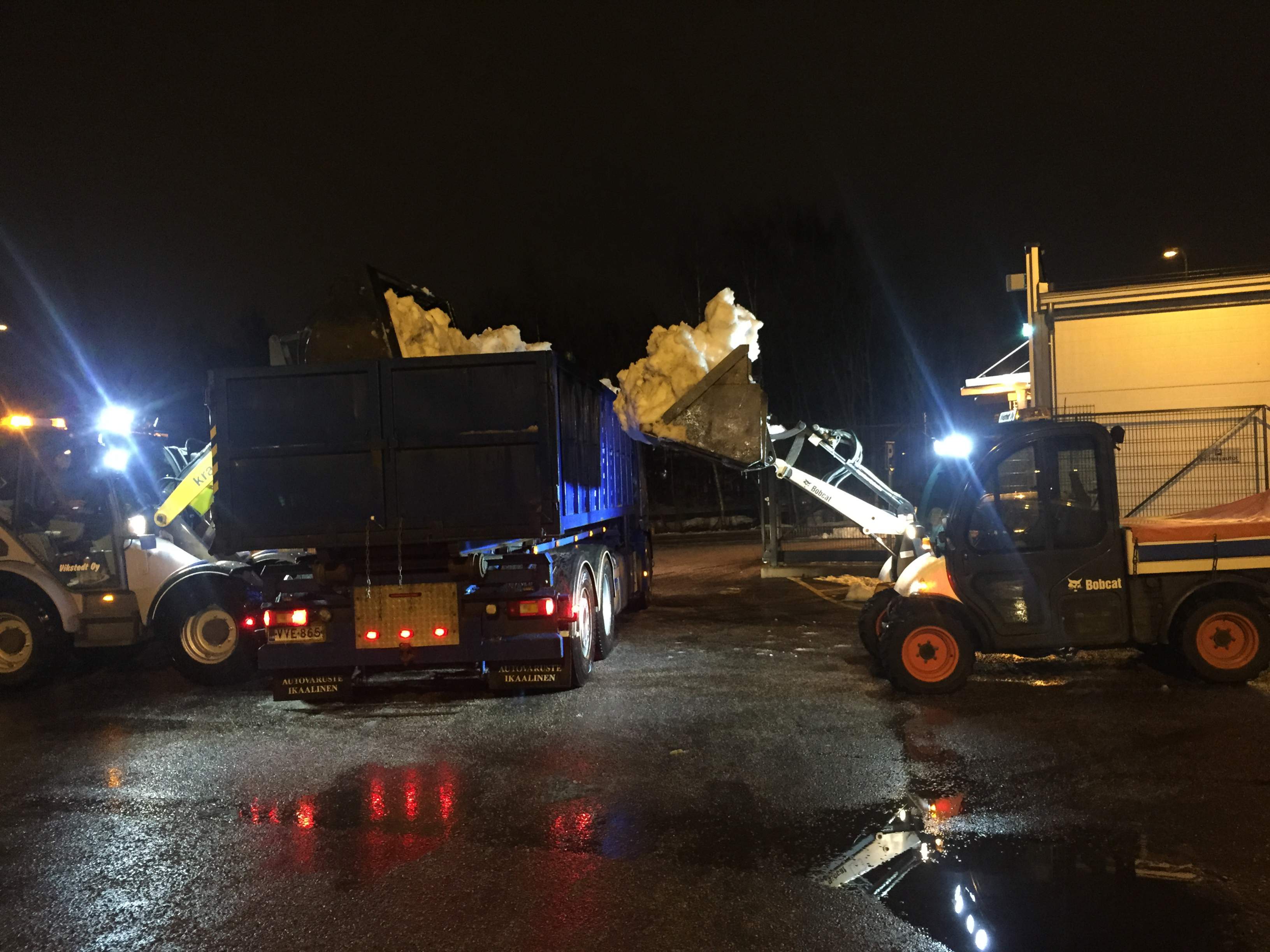

It worked well for the whole winter, only one hose had to be changed. Traction and push power surprised me. Lift height isn't good enough for loading :D , but that's why we have bigger machines.
