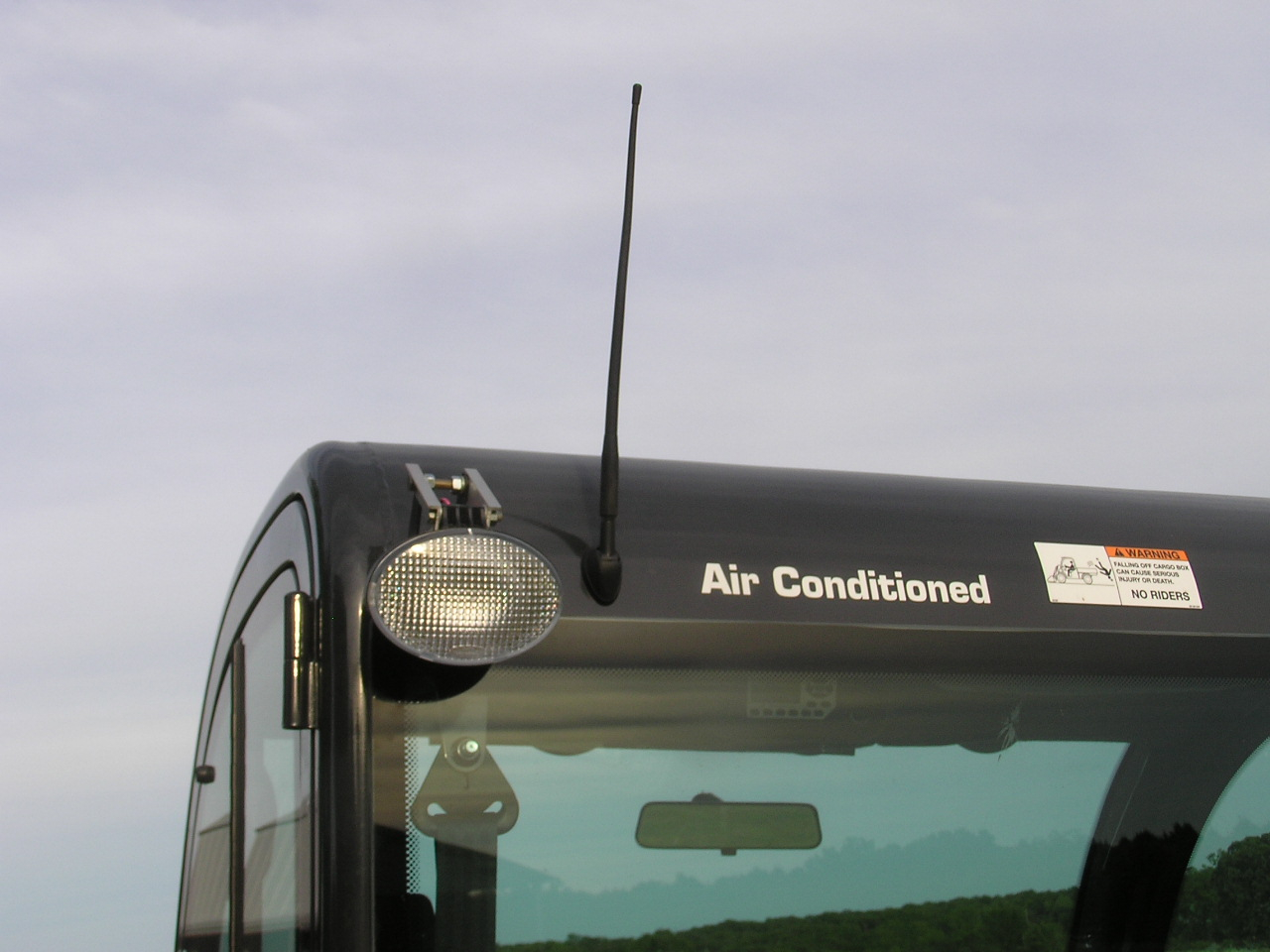

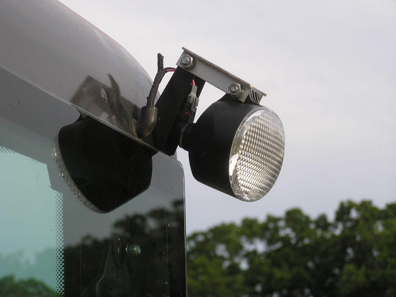

   / Toolcat Modifications: #3
Speaking of mowing under and around lots of trees. I lowered the rear work lights:
Used some small thin aluminum angle and a 5/16" bolt threaded clear to the head.
