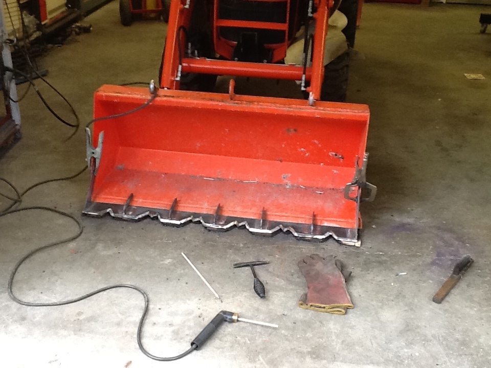

I picked this up at a farm sale cheap. Had to narrow it down a few inches. Looks close to the W.R. Long set up so I would vote W.R. Long. It works good enough that its almost always on my tractor.

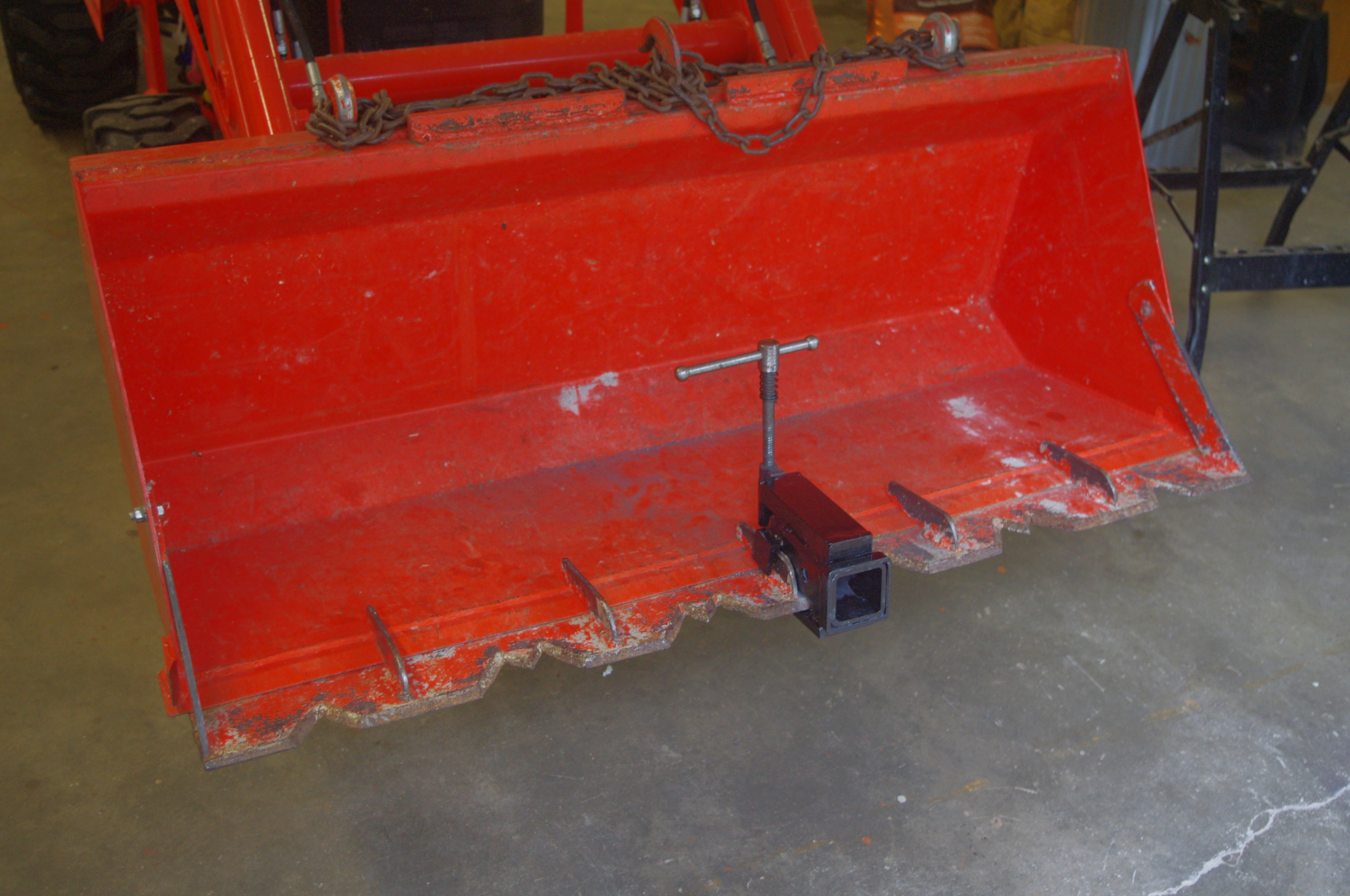

I made a tooth bar from 3/8 x 6 inch flat stock. I first used a plywood template as a guide, and used a torch to cut the teeth. I had planned to cut 5 "W"'s into the bar, but apparently I can't count 'cause I had ended up with 4. On another mod., the ball hitch receiver locks over one of the tooth bar supports.
