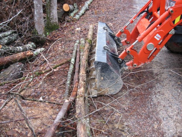

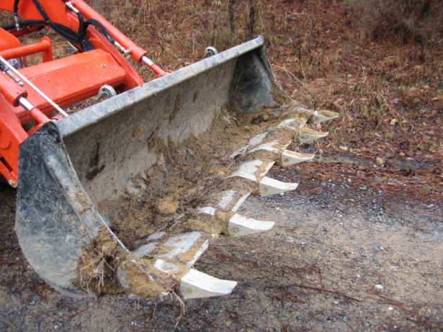

Any pics of you using it?
I took a couple of pictures of the tooth bar in action. This first set of photos shows the toothbar all dirty and a part of the overall bucket, along with some shots scooping and moving brush.
The teeth give you a short fork to aid in getting under any material you want to lift or push. I tried to get a shot showing the teeth moving under the small trees that I wanted to place on a larger pile. One shot shows how the teeth help hold the material in place, until dumped. The last photo shows a larger log. I picked it up by approaching from downhill, and with a little coaxing.

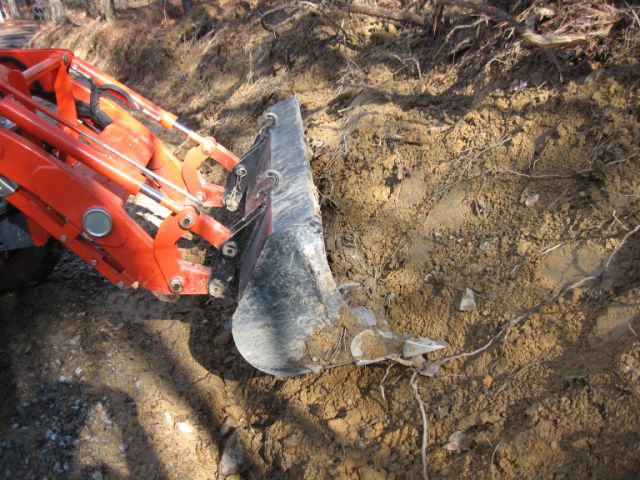

   / Tooth Bar: What a difference
Next, I have been working on the ditches on each side of my drive. One side has a bank that I wanted to angle a bit, and I needed the dirt in other areas. These pictures show the toothbar cutting into the bank, the load of dirt you are able to get because the tooth bar breaks up the soil for you, and the tooth marks in the bank to show how it digs in.
One thing to note. With the bar the bucket will easily and quickly get into the soil at a depth that the curl and lift will not handle. I did not remember the bucket straight edge doing that so easily. I find that I have to back off to allow the curl and lift to work. Takes some practice, and I need a lot more.

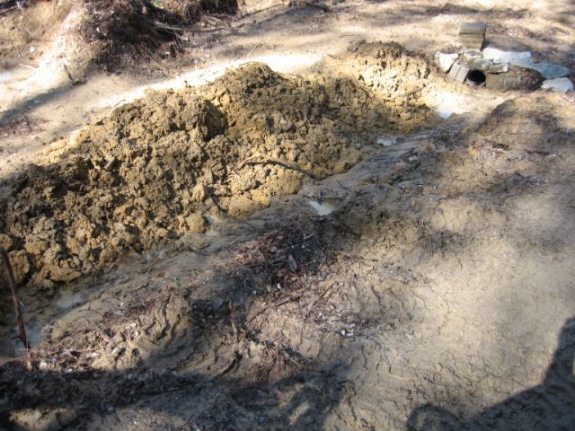

Another job involved preparing the other side of the drive for another section of culvert pipe. In these shots you can see the bucket angle dig into the ditch, loosen the dirt so that it is easily scooped out. The last shot shows the ditch (aka mud hole these days) ready for another pipe. Hopefully, one of these days the land will dry out enough so I can smooth the new area over the culvert pipe and cover it with #57 gravel.
These jobs could have been done without the toothbar, and in the last couple of months I have done similar jobs without it. My conclusion is the jobs are much easier with the bar--(1) scooping items into the bucket and (2) loosening the soil. I understand that it will help me greatly when I get ready to move rock and rip rap.
