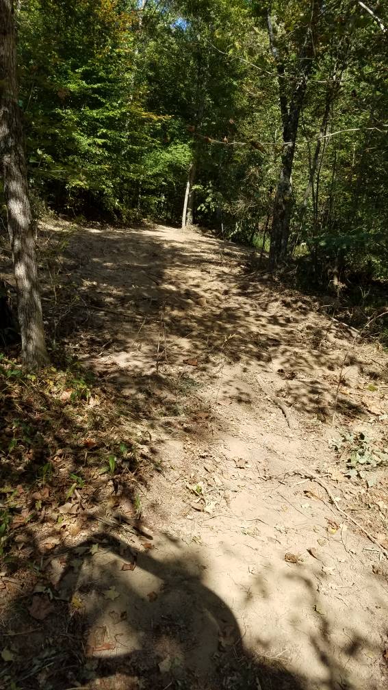

I've had my tractor for a week so I'm very new. When I purchased I ordered a woods tooth bar from the dealership, still waiting to come in and they will install. I'm wondering now though if a bxpanded piranha toothbar would be better as the teeth are closer together and not so spaced out? I've been digging out saplings and hundreds of rocks so far, I've read the woods brand are better on rocks. I'm too inexperienced to know which is best. So far I've had good luck with the bucket digging in front of the sapling a bit or rock then after digging in front of it then popping the roots out. Sometimes coming in again on the backside or different t angle. I like food plots and I want to run my tiller in woods. I would also like to dig my own pond in the future if even possible and dig a road out make it level. Thank you. Added a picture of my work. 20190919_144446.jpeg
