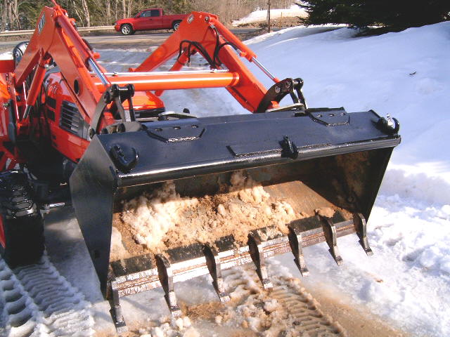

Attached is a picture of my bucket.
I have 3 bucket hooks, 1 on each side and 1 in the middle.
The toothbar is a WR Long, cost with shipping was around $300.

hambob, One thing to consider, when getting a tooth bar, is the edge of your bucket. If you get a bolt on edge on your bucket the spacing of the teeth becomes critical because the teeth will fit in-between the protruding bolts of the bolt on edge. On Markham's web page they say that their toobars are designed for buckets without the bolt on edge. <font color="blue"> Markham - "They will Not Fit with Bolt-On Cutting Edges, Unless you are willing to remove all the bolts in that cutting edge before installing our tooth bar."
</font>
I have a bolt on edge and my dealer had to give all the measurement of the bolts to FFC so the toothbar they built would not have to go over the bolts.
Hooks - One thing to consider here is that when you pull with with the hook it is best to have the load equal on the bucket so you do not twist the loader. My dealer would only install (free) one in the center for this reason. I can see where three would be good for holding things in the bucket. I just would not pull from an end hook.

Thanks for all the advice. I just called the dealer and he will install a toothbar for $325 before deliveryplus he will space three hooks along the top. His family has had farm equipment dealership for close to 70 years, and ought to know better than me where and how to attach. He can also do it easier. I may be cheap, but I am also lazy. Otherwise I would just tell the wife and kids what I want moved. Its easier to do it with my toys.
   / toothbar for fel #8
<font color="blue"> he will space three hooks along the top. </font>
In the photo Vince posted you can see a grab hook in the center and slip hooks at the ends...
My choice was a slip hook in the center and grab hooks at the ends...
There have been times when I told myself I was glad my slip hook was in the center, probably because it was easier to take up the slack chain by pulling from the side before hooking into the grab hook.
Wonder what configuration of hooks is best? Maybe all are equally good. I am almost certain that I would not want all slip hooks though. At least one grab hook would be a necessity in my book.
Might not hurt to ask the dealer what kind of hooks he is welding on, just to be sure.
