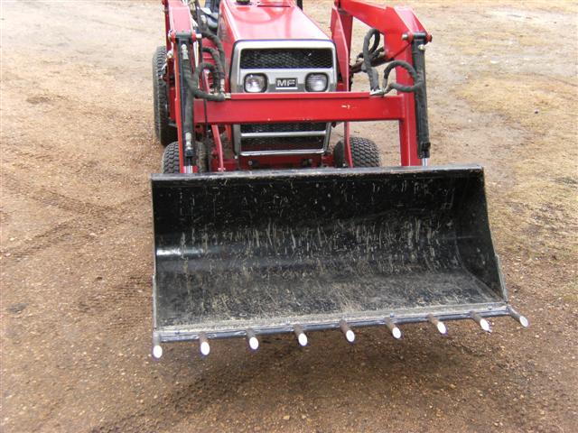

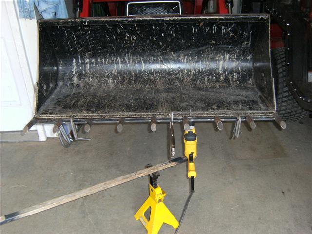

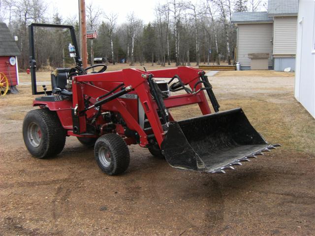

I made a tooth bar that bolts onto the front cutting edge that I can use on either my MF 1655 or my MF Gc 2300 bucket.[pics show it on the MF 1655] for the little bit I've used it so far I don't like it.Digging etc seems to work better just using the bucket.I guess maybe back blading and piling small bush is ok.I can say I tried using it digging into pushed up piles of dirt/clay where small roots and trees were growing up and didn't think it worked to good.I had better luck with just the bucket.So depends on what your going to be doing with yours.
