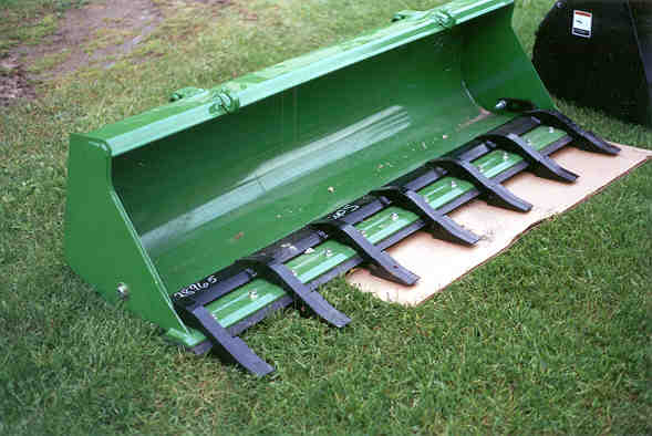

See attachment for pic of my bolt on toothbar that's on my JD 4710. Your $350 price sounds about right. You can order one of these from KC-Canary, Fultonville, NY. Call Mark Brucker at 518-853-3405. Let him know your inside dimensions of the bucket and he can order and have it shipped to you or your dealer for install.
IMO, the bolt on toothbar is better than weld on ones. Take notice of mine. I can remove at will to replace the bolt on cutting edge if I ever have to. Your weld on ones are permanent. What would you do if you had to replace the cutting edge?
As JMIII used to say, with one of these babies you'd think your bucket was on steroids. It'll turn your little compact tractor and FEL into a bona fide tyrannosaurus . /forums/images/graemlins/grin.gif /forums/images/graemlins/grin.gif /forums/images/graemlins/grin.gif
....Bob
