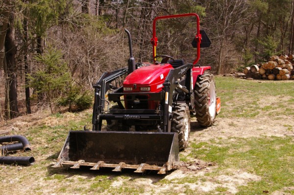

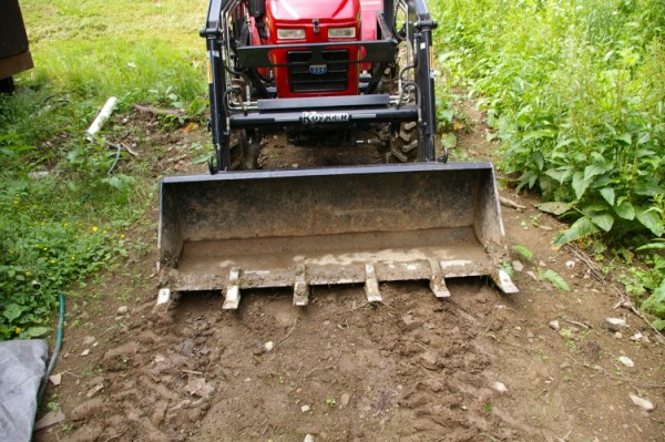

I had a Koyker 160 and put a Markham toothbar on it. The difference was incredible. You just have to take your time and try to keep it out of 4WD if possible so you don't strain the front axle. I had 160 on my 224 and it was a workhorse.
