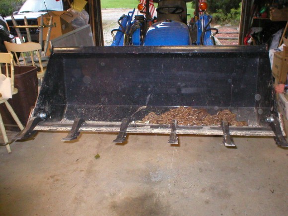

Here are some photos as I put my toothbar on last night. The 54" toothbar weighs about 60-70 lbs I'd say.

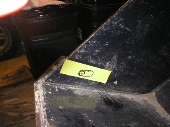

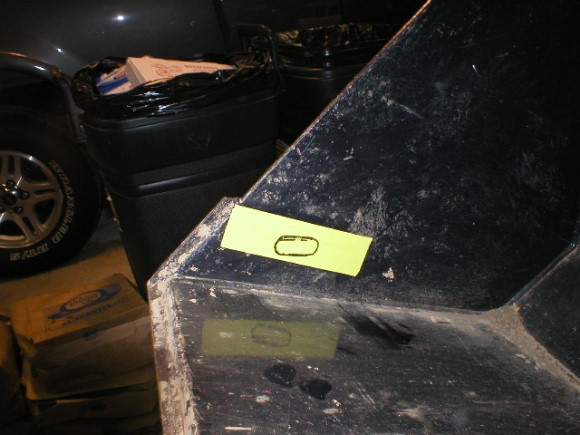

I used yellow duct tape under the ears so I could see where to drill the holes. Hard to see a black Sharpie mark on a black bucket.

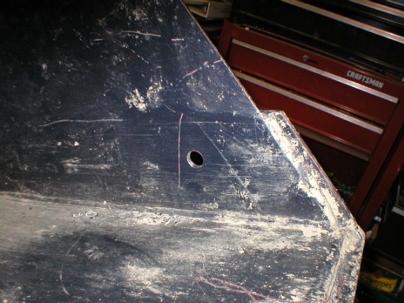

Holes are marked on both sides

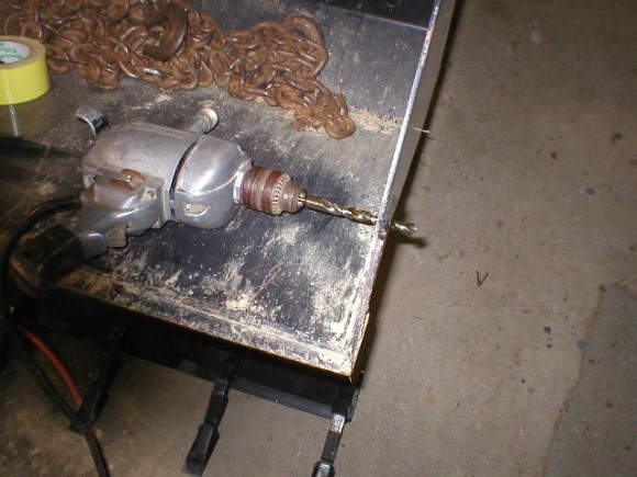

Used a 1/4" hole to start. DeWalt pilot tip bits are great.

Next went to a 1/2" hole on both sides

Thought you'd like to see the late 50's, early 60's era 1/2" Craftsman Drill I used. It only runs at 600 RPM, but as you can see has enough torque to snap the rear handle off of it. I did that years ago. While drilling these holes, I think the RPM may have dropped to 595..... /forums/images/graemlins/grin.gif

Total time, 50 minutes, including going out back to bring the tractor around, taking pics and cleaning up
