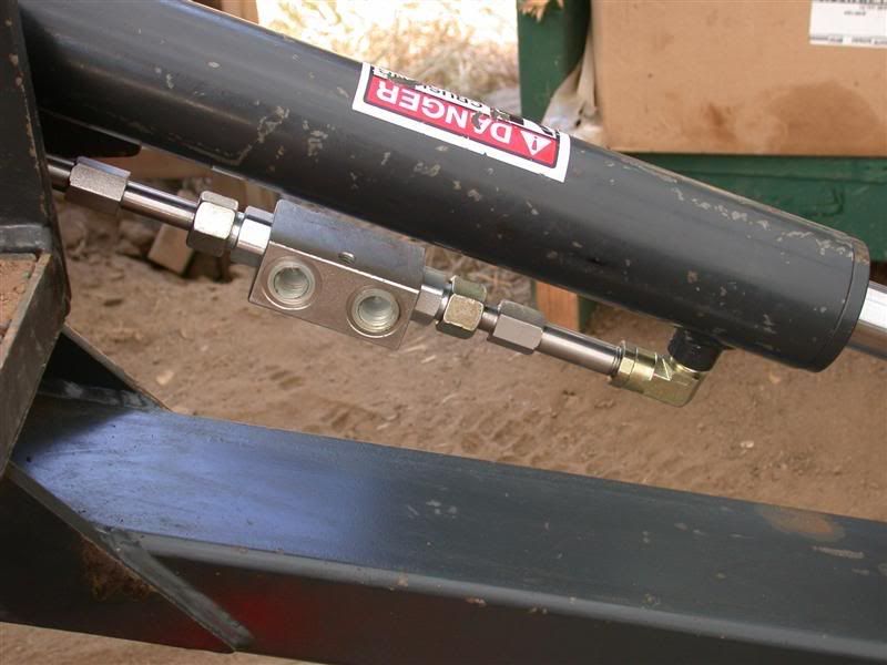

My top cylinder does not have a check valve asm. Seems like a good idea.
Called Carter & Carter they don't sell the check valve assemblies separate.
Anybody know where to get a small double check valve? It will never package as nice as a built in one with banjo fittings though.
Although the C & C web site says you can pick and chose as much as you want?
   / top link check valve #3

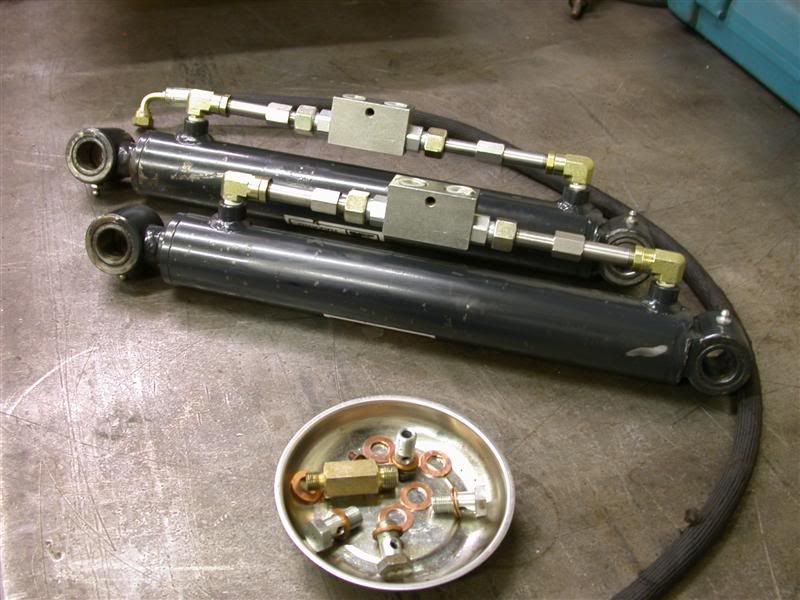

You gonna need a Double Pilot Operated Check Valve or "Lock Valve" like this one:
DOUBLE PILOT OPERATED CHECK VALVE
I got those for my side link cylinders and they are pretty big. But I put them on really big cylinders and they work great.
I know from time to time CCM has their DPOCV's for sale, but I may have bought the last ones? They are much smaller than the ones at Surplus Center. I put them (CCM's) on my backhoe stabilizer legs to eliminate leak down and they work great too. I would prefer the CCM DPOCV's any day.
yeah the ccm ones are the ones. A 30gpm valve is kind of big for 1/4" lines on a top cylinder. Even with 1/4 lines it is going to fast
