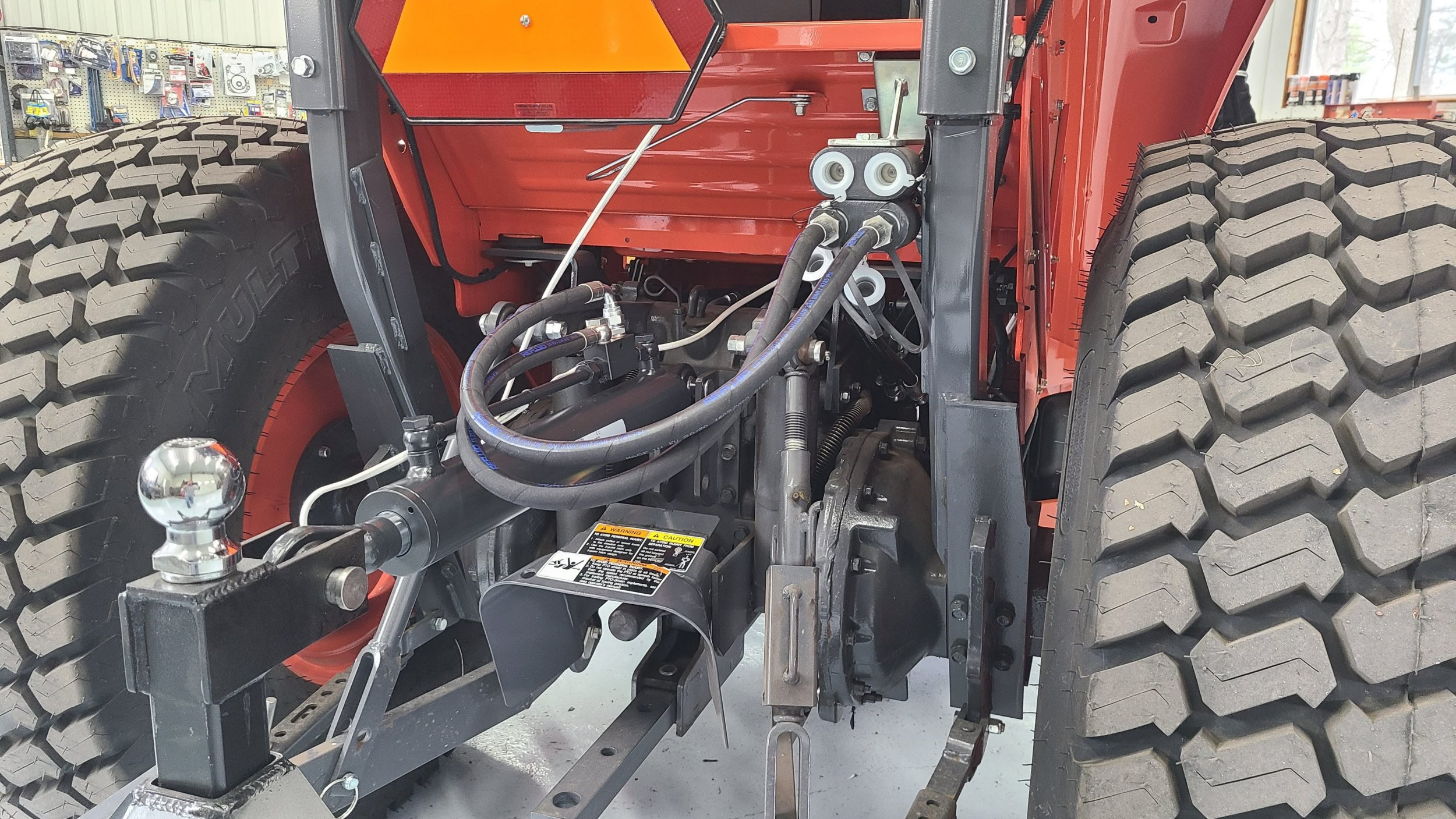

Pretty easy install, waiting for the ram to get back in stock was rhe hard part lol. I am happy with a clean installation! 5460 tractor by the way...

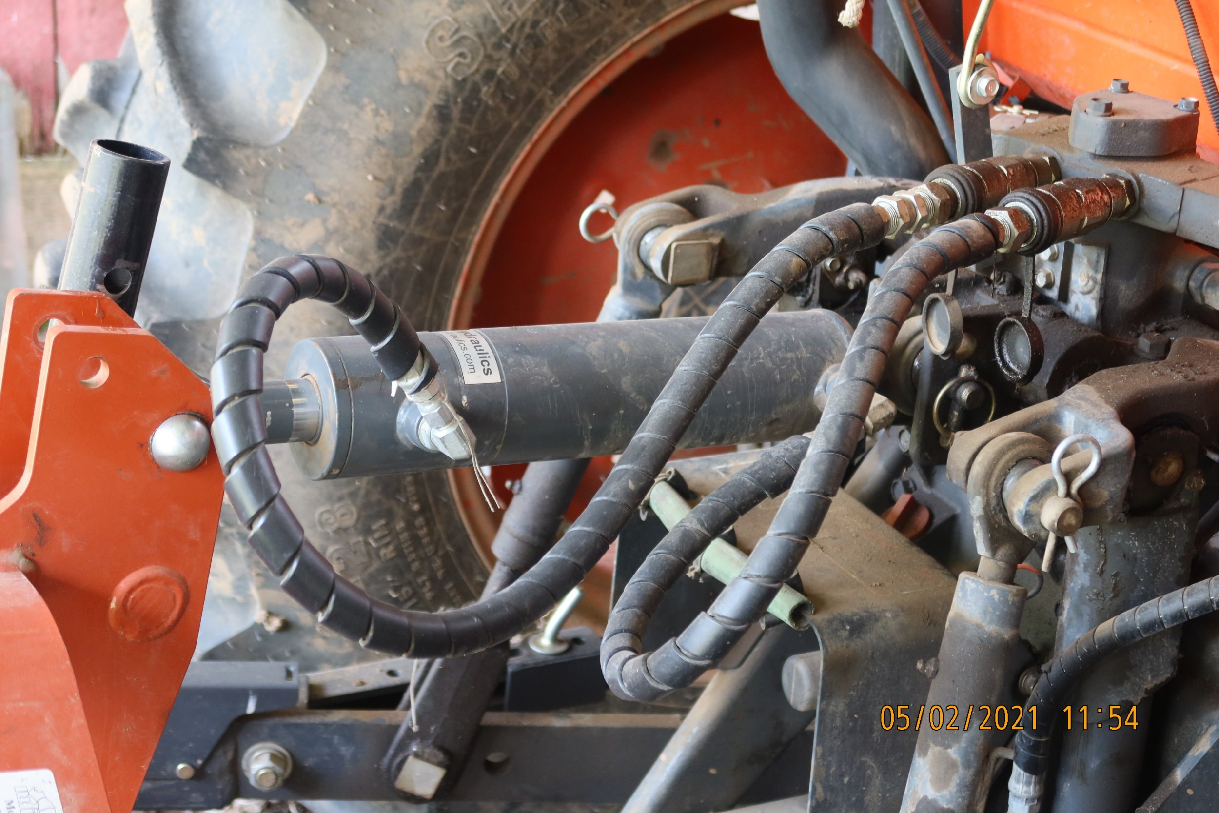

   / Top link installed #2
It look a lot like mine. My dealer said has having trouble keeping them on shelf.
The wire tied to the cylinder is for giving power to trailers to release brakes for back up. We move a lot of trailers and many of them the brakes lock up in reverse if you don't have power to release them

My hydraulic top link is from Fit Rite. Got is seven years ago. It's become a permanent fixture. I even use it to set my Wallenstein chipper down - flat on the ground. Particularly useful with my - rear blade, LPGS, ROBB, disk harrow and mold board plow.
   / Top link installed #9
Top link has been there, transferred from old tractor. Put the tilt on yesterday. It sure makes a difference with the box blade.
   / Top link installed #10
When I worked for a Kubota dealer, I installed quite a few T-N-T kits. We would use Gearmore kits out of California. They use a fender mounted 2 or 3 spool valve. I would usually install the 3 spool so that the customer had a 3rd spool available for another function if needed. Cost wasn't that much. Also installed quick couplers on all 3 functions so that the TPH could be removed if necessary. IE installing a backhoe. Just checked and you can get Kubota 2 spool factory style for the B series and 3 spool for the L series. Just remember, the cylinders would have to be ordered separately. I have also installed these. I think if I was going with a new unit, I would use the Kubota style as you won't have the valve and hoses on top of the fender. Just my thoughts.
