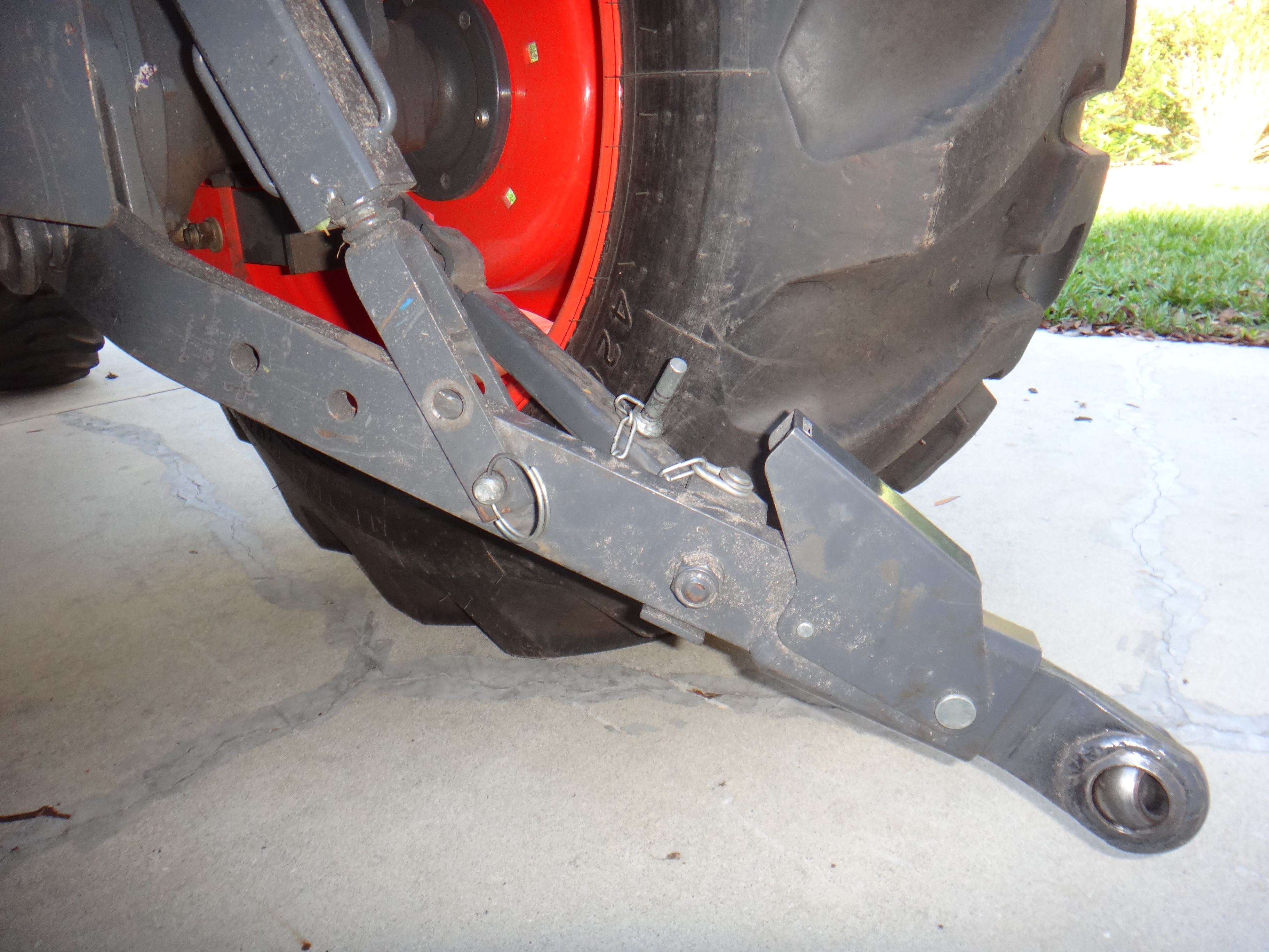

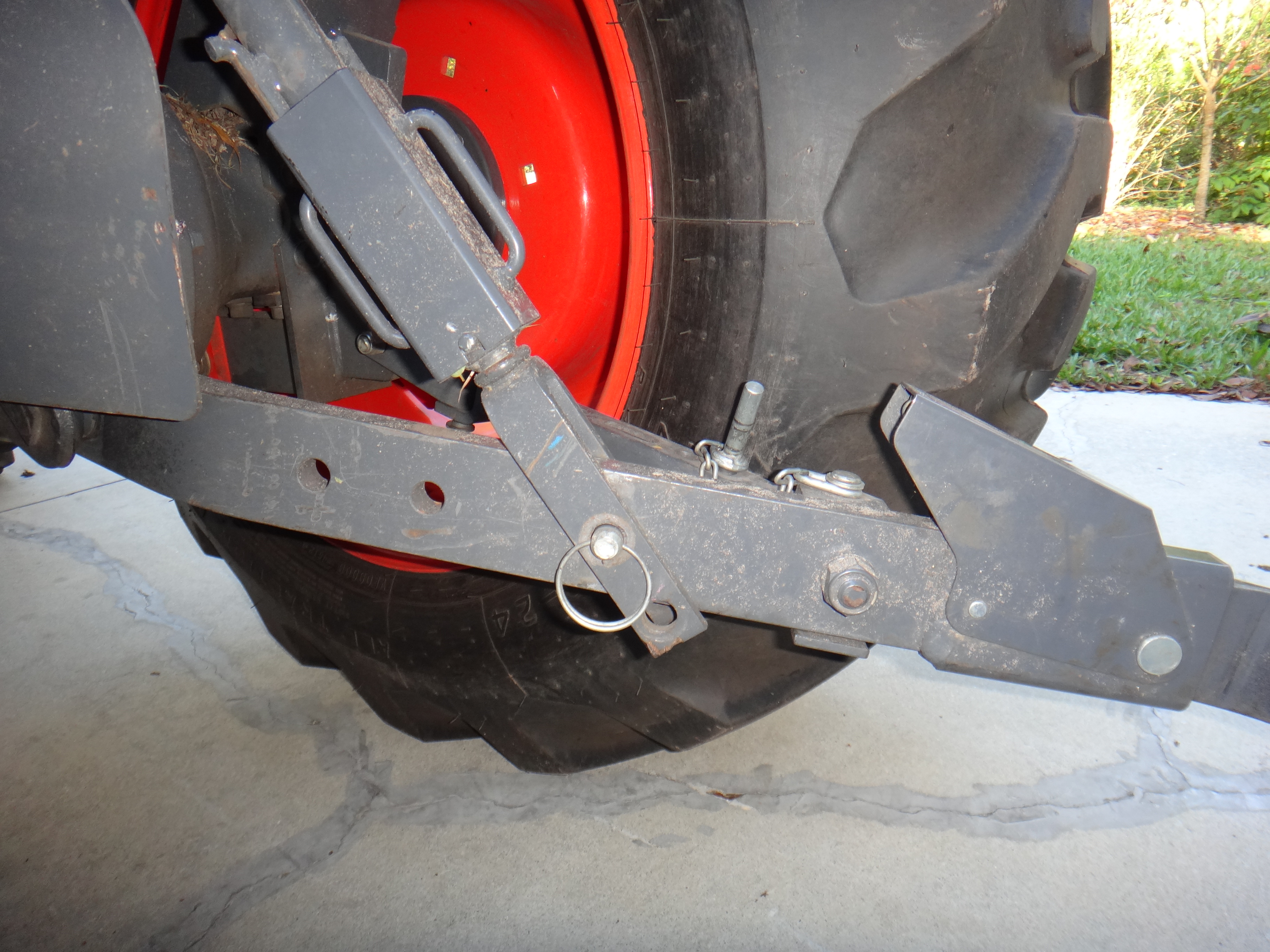

Are your Lifting Rod stirrups set in the upper hole positions? Difference between lower and upper holes is about 5" in lift. Top holes are the "normal" setting. (Photo #2) ((Higher hole = Higher lift))
See two photos.
