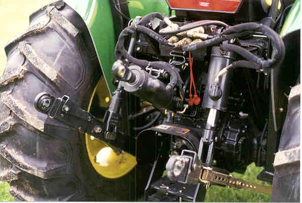

<font color="blue"> I've had difficulty understanding what this option is exactly, and what the cost/benefits of it are? </font>
Others here have explained the benefits well enough. Here now is a pic of Top-N-Tilt on my JD 4710.
...Bob

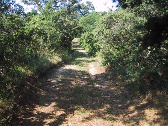

Thanks for a great explanation! I've got the problem of keeping the edges of my dirt road cleared of brush that creeps in. (see attached picture) Problem is that the road has sunk a little and the edge tends to be almost a foot higher than the road itself.
Do you think with this Top-N-Tilt rig I can get the rotary cutter up onto the edge by backing onto it? If I could that would be terrific and make the Top-N-Tilt a great investment.

How thick is the brush? 2 inch saplings could be cut with a medium duty cutter like the JD MX5, but backing into them might be problematic. The road looks sort of narrow for a CUT and a rotary cutter to work sideways on. I'm sure you'd be scalping the high edge of the ruts, too Top-N-Tilt or no. If the terrain allows and the thickest brush isn't much more than two inches maybe you could just drive up and down the side of the road and mow it down with a good cutter. I've mowed down stuff that looked pretty thick without a whimper from my 4310/MX5 combo. Or, maybe you could use a HD loader bucket and a toothbar to push the encroaching trees and brush over. If it's too thick for that then I'd think about hiring a dozer to get it all into shape and using the CUT to keep it that way. If you do use a cutter to knock it down be sure to keep the loader bucket low to bend/break the brush down so it doesn't bash against the bottom of the tractor (wiring and suction filters can be damaged if you high-center on something)
Maybe someone with more experience can offer better advice.

Thanks -- forgot to mention that it's a 4410 w/ MX5 cutter. You're right about driving down the side of the road where possible -- that would do it (except where there are trees bigger than 2"). The goal would be to cut back about 5' on either side of the road (that would allow a bigger vehicle to get buy with no scratching at all).
But would the Top-N-Tilt be helpful then? Not really needed it seems except where I could back across the road from one side and lift the cutter up and set it down on the other side next to a big tree for example.
How high can you raise the cutter with a Top-N-Tilt compared to standard 3PH lift? I would guess that tilt doesn't really help since it adjusts the angle and not the height.

I don't think you'd regret having TnT, but you have to decide the cost-benefit based on your needs and budget. I don't think I've every used my cutter without using TnT somewhere and looking at your road I would guess you'd find it very beneficial. As far as raising it, you will be able to raise the back end of the MX5 somewhere around a foot above normal 3ph height but the front height won't change much when you do.
   / Top-N-Tilt for 4000 series #10
Bebster,
I think that brush may be a little too much for a sickle-bar mower. However, others who use them could tell you better. You would definitely need to cut the thick stuff first with a chainsaw or your MX5. The nice thing about a sickle bar mower is you can use it at any angle from 90 degrees verticle to 70 degrees downward. With a 7' sickle bar mower, you could drive along side the road with it verticle and trim out a 7' wall of light brush ... maybe. /forums/images/graemlins/confused.gif
