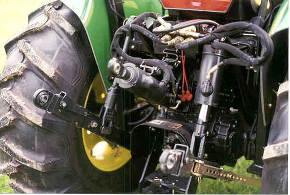

See attached pic of the top and tilt set up on my JD 4710. FWIW, this set up was installed by my dealer, KC-Canary of Fultonville, NY. It did require some significant knowledge in hydraulics and the technician who did the install mentioned it was somewhat time consuming to do the install. Everything works great though and I'm glad I had the dealer do this as opposed to someone else.

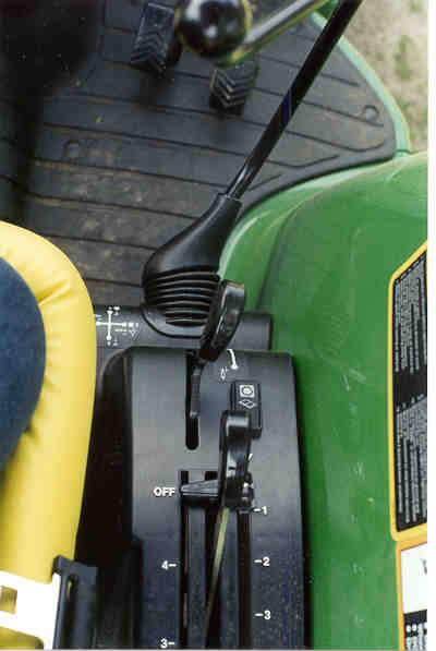

...and this is a pic of the SCV control set up next to the operator's seat.

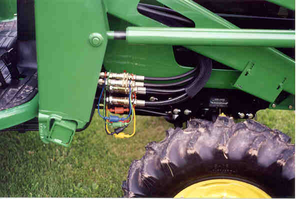

Lastly, this is a pic of the color coded SCV hydraulic set up (5 SCVs) that control a) the 3 hydraulic functions for my 4in1 bucket and b) with use of diverter valve, the TnT functions in the rear.

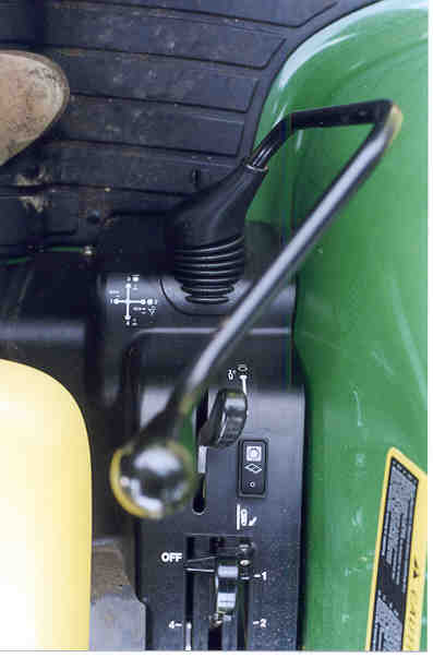

...another pic of the SCV controls...

Thanks Bob, Looks awesome. Is that the diverter switch that is on the front. It looks like it has a book icon...
   / Top N Tilt on 4000TEN #9
<font color="blue">"...Is that the diverter switch that is on the front..." </font>
Yep...that's right Mike. It's real easy to operate. I press that switch down, red light comes on in a small window on the diverter switch, and my FEL's hydraulic functions transfer immediately to the rear to operate the top and tilt functions. This was much easier and less expensive to install than putting in a switch called a Fasse valve in on top of the FEL's joystick. This is the standard Deere install procedure. Going with a Fasse valve would have cost me a few hundred more and I just couldn't rationalize this. I saved this money instead and used it to buy some forks. /forums/images/graemlins/smile.gif
