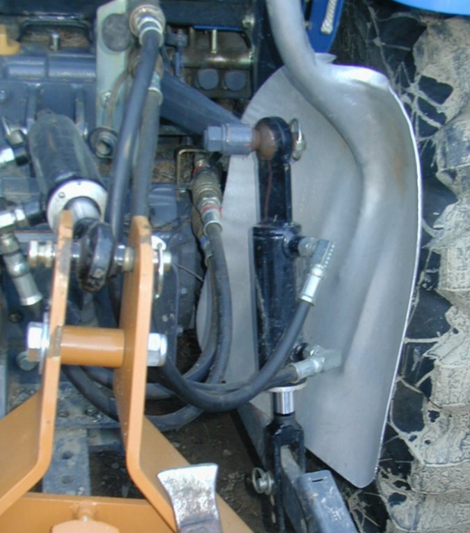

I have TnT on my TC33D. The remotes and cylinders were installed by my dealer, though I've heard it's not tough to do yourself. It was done with Tisco cylinders, made for that purpose. None of the available standard Tisco toplink cylinders were the right length as-is. I bought one that had an 8" stroke, and had to get the link shortened to work properly with my boxblade. Fortunately, the cylinder had a long bracket on one end that just had to be cut down to size.
I've attached a picture of my side link. (sorry it's a bit blurry. The shovel is there just to provide a background color different than the black cylinder) You can see that the upper end of the cylinder has a long piece of flat stock on one end, with the ball mounted on the end of it. The side link worked OK as-is. You can't see it in the toplink, but that flat stock was cut off and the ball welded to the base of the cylinder. (Let me know if you need the final dimensions I ended up with, and I'll go out and check.)
It all works fine, though I have had some problems with a slow "leak-down" on my sidelink cylinder. I've heard of some others with the same problem on Tisco cylinders. Other brands may work better (Gannon??).

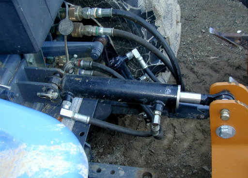

Another shot with a better view of the toplink. There was some flat stock welded on the base of the cylinder on the tractor end. This has been removed, and the ball welded directly to the base of the cylinder (be carefull not to overheat the cylinder when cutting and welding).
If I had it to do over again, I would have left about 1/2" or 3/4" of the flat stock in place, since the cylinder tends to bind up in the mounting bracket when I use the lower mounting hole. Cylinder is shown fully retracted; I could have taken a bit off the shaft end to make up for the extra bit I should have left on the flat stock.
