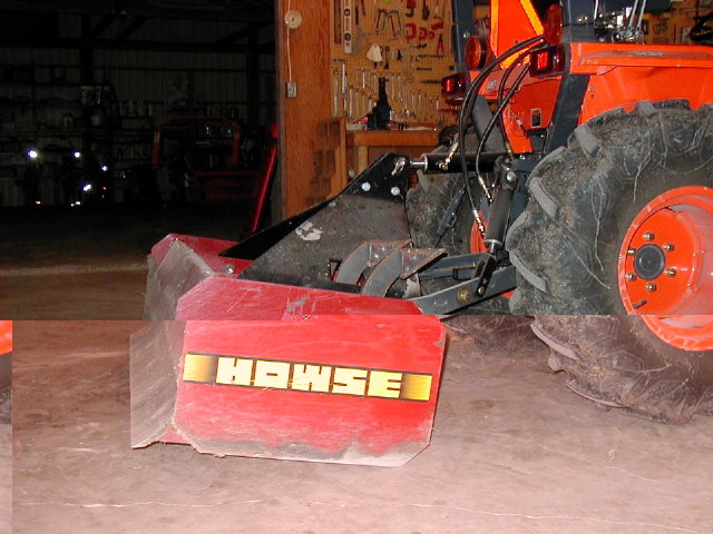

My dealer just installed the T&T on my DK40. I have a 7' HD box that is the main candidate for the system. However, the top cylinder is not long enough to tilt the box back so i can just smooth a driveway. It tilts way forward, but can only return to level. Do i have the wrong cylinder or do i need to modify the BB. It looks like it is about 4-6" too short(no it is not an Irish thing either:D )
The side link works fine & i am, able to tilt it to either side.

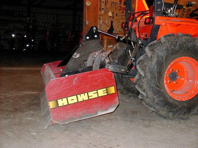

Yep, I was able to tilt my box blade forward or back far enough to smooth the dirt or gravel I spread. In fact, I found it made a fast job of smoothing if I tilted it all the way back, ran forward, then tilted it all the way forward and ran backwards. Back and forth a couple of times and it would be smooth.
