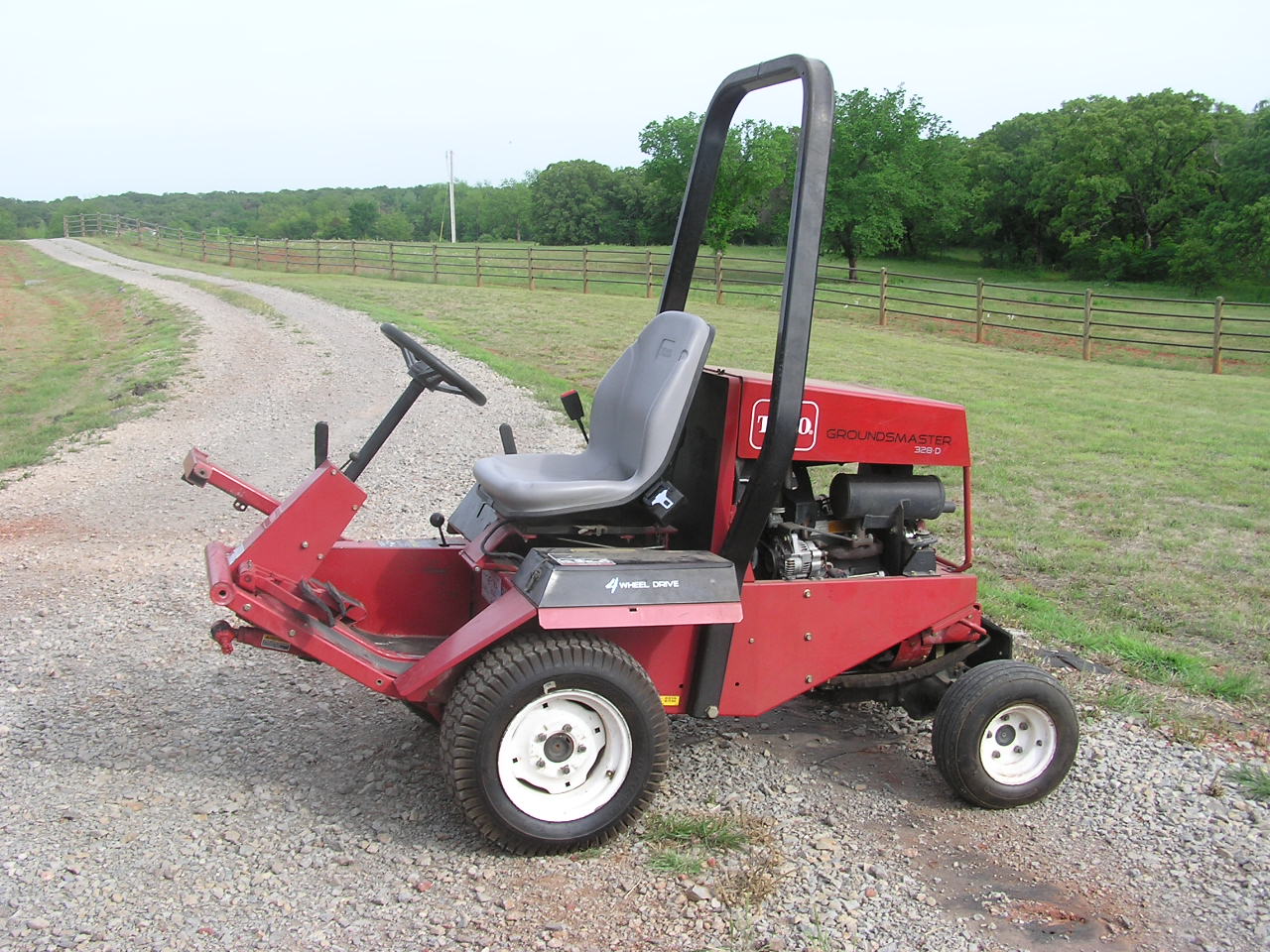

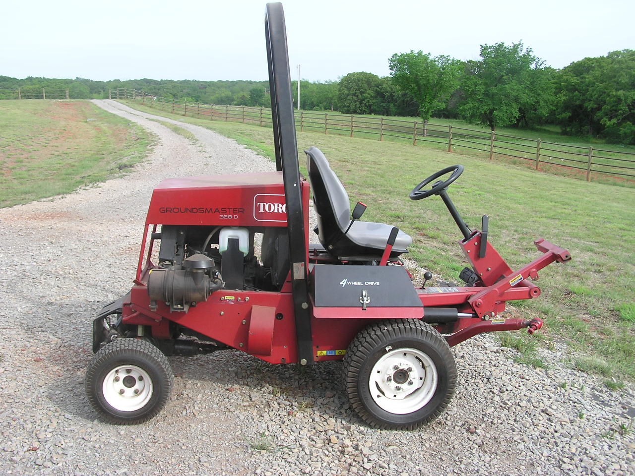

What series is it? I have a 328D, model 30627, that uses a 3 cylinder Kubota D1105-EU2 engine, but no experience with the solenoid.
