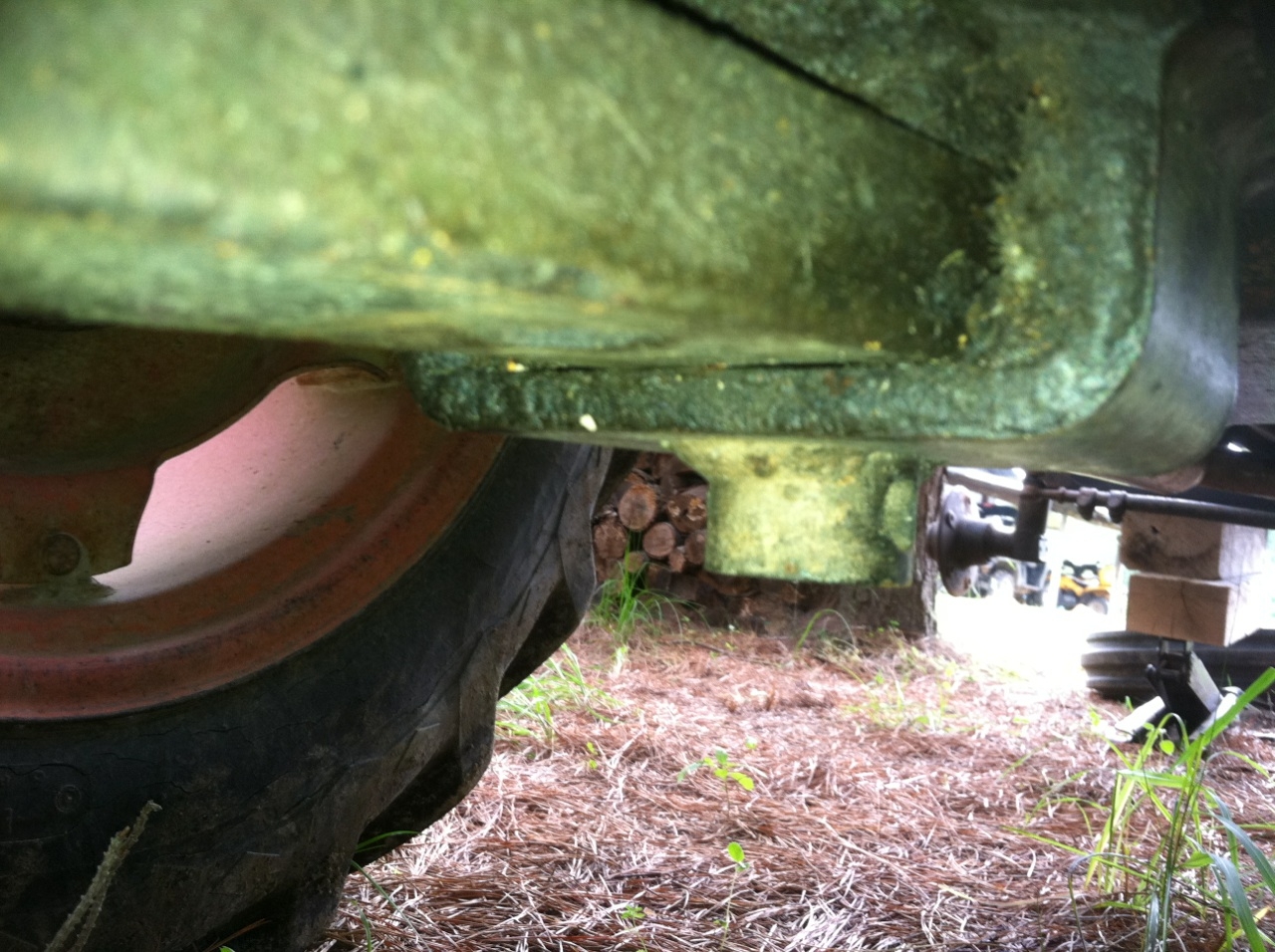

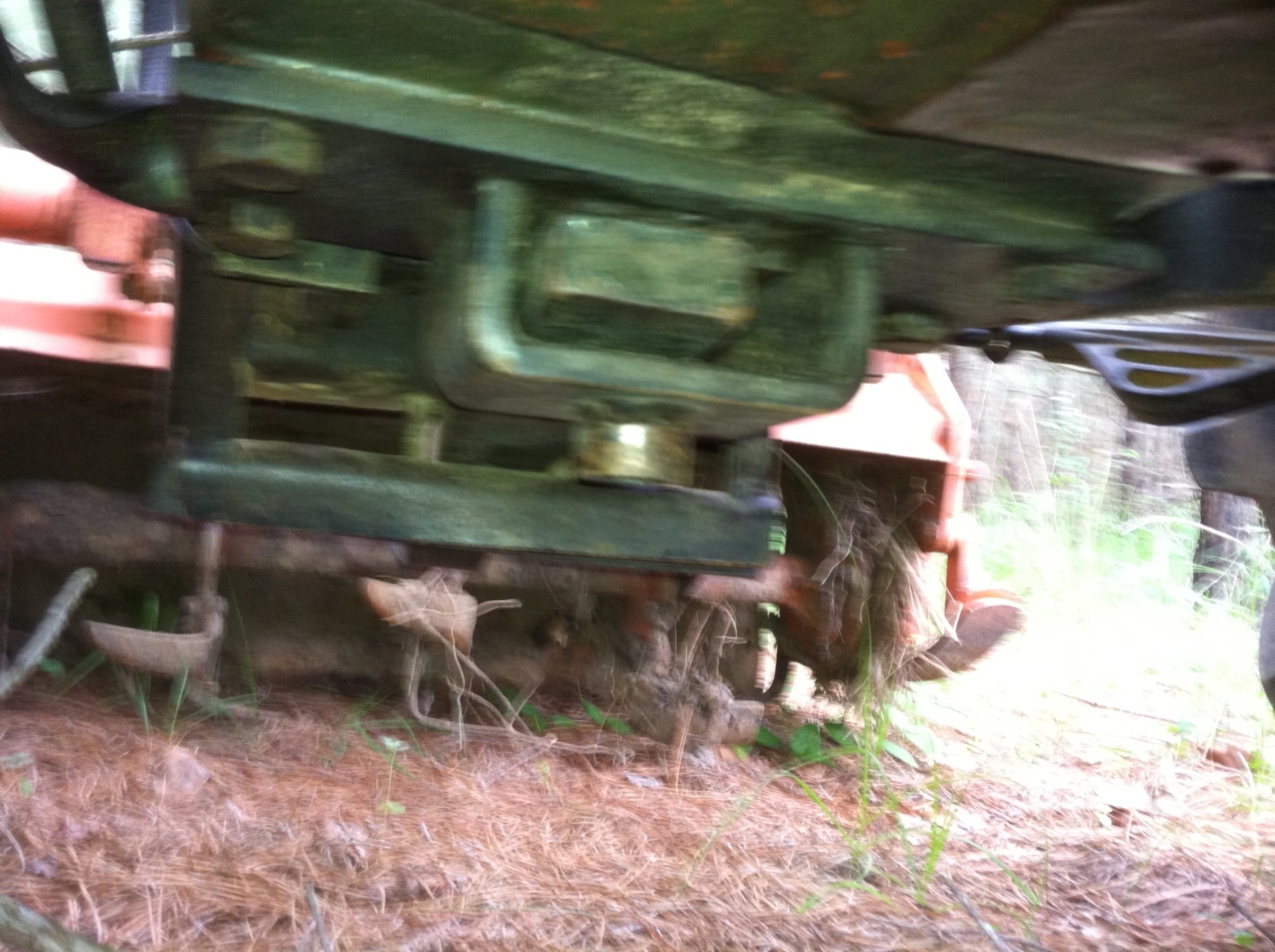

I purchased a Deutz 3006 tractor and the guy handed me the tow hitch and said the bolt had came out of it. I have looked at a parts manual for the tractor and it doesn't show it. Im going to attach a picture that will show where the pin goes and it looks like there is a place for a bolt and maybe a pin to go thru the bolt. Before I order one I want to make sure I get the right thing.
The pictures show the tow hitch in its place.

Ok I have found out that this is a draw bar pin. To order one that came on my tractor will cost me 48.00 and this includes shipping so I'm going to try and make one before I pay that.
It looks like I will need to measure the dia. of the hole and find a bolt that will measure that dia and then stick it up thru the Draw Bar until it bottoms out then with a sharpie mark the location where the pin goes thru. Take and cut the bolt to that length and then drill the hole thru the bolt for a pin. Is this it or is there something I'm missing about a pin that I have never seen. Thanks Rick
   / Tow hitch bolt #3
Forget all that drilling. Just get a CAT 1 lift pin and cut it to length. It already has the hole in it. If CAT 1 don't fit try another CAT size.

Did the cat 1 work?
   / Tow hitch bolt
I think one of the cat. Pins will. Have to wait until I can get back down to the farm and measure the dia. Of hole. Daughter is graduating high school this weekend so I will be cooking BBQ for her party. Will post when I find out. Rick
