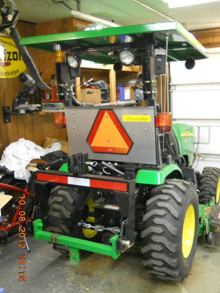

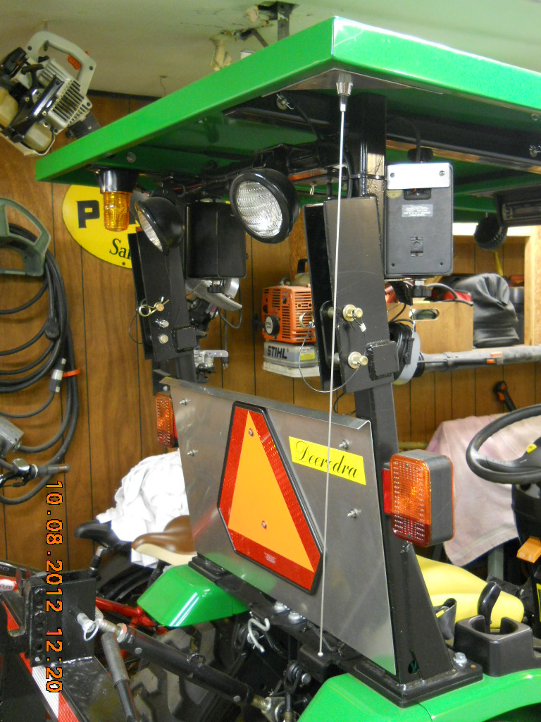

i am adding some rear protection to the back of my tractor.
a solid piece of metal on the bottom of the rops.
then i was going to frame in a piece of expaned metal, heavy mesh steel or punched sheet steel to mount to the rops.
tom
ideas anyone?
any pictures new tractor 309.JPGnew tractor 310.JPGnew tractor 311.JPGnew tractor 313.JPG of what you have done?

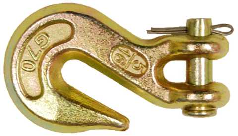

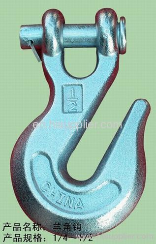

we never though the grab hook would pull thru the steel frame.
Some grab hooks have a nearly sharp wedge shape where it would meet the frame.
Others are lots more rounded.
A grab hook is designed solely for the purpose of linking back onto the pulling or lifting chain, attaching a grab hook directly to any item you're wishing to retrieve is tempting undesirable outcomes......

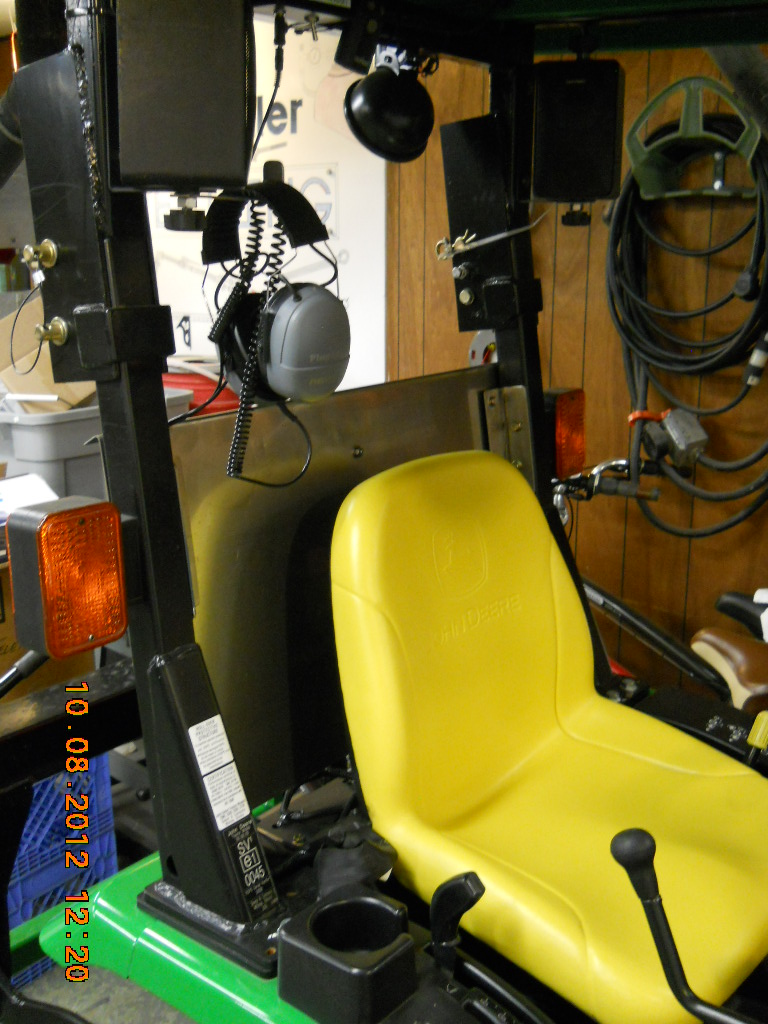

I like the way you have the radio installed.
