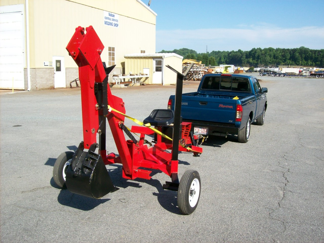

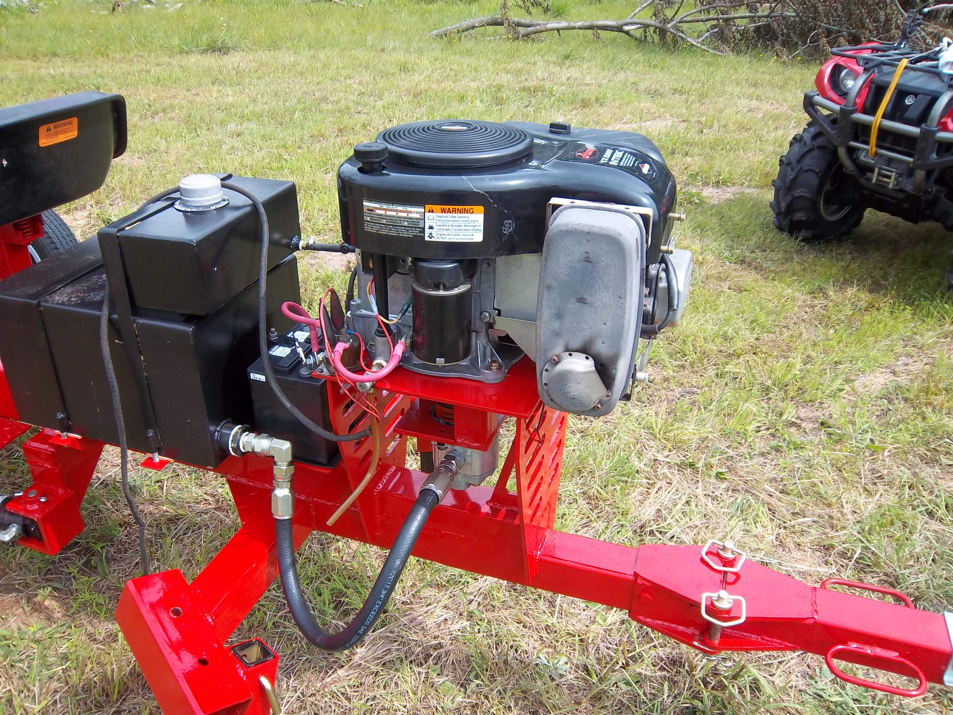

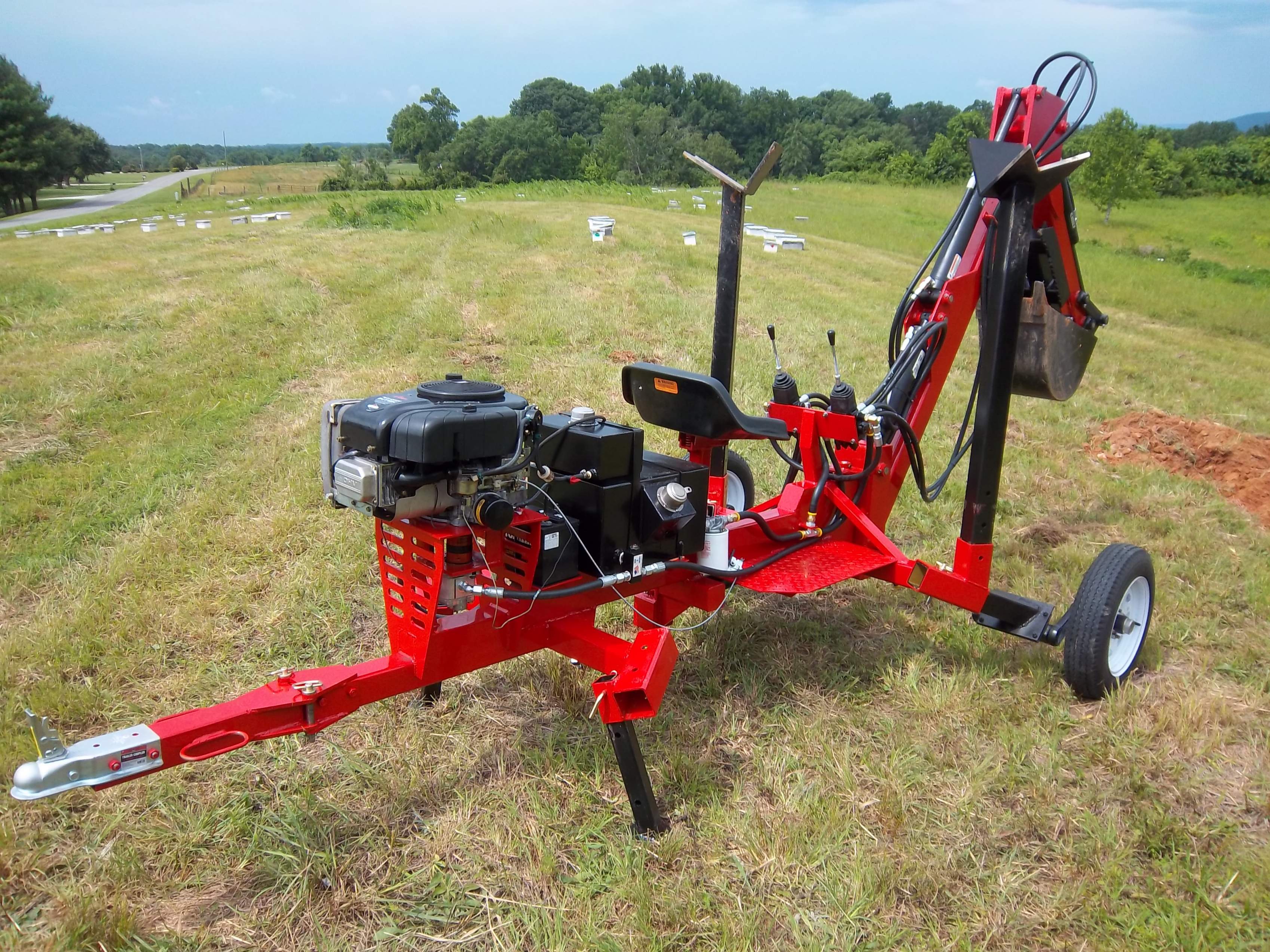

Decided on the UBUILDIT Ground Hawg plans which I have recieved today, won't to thank everyone for there imput. Now it's time to studie the plans and round up the supplies to make it happen. So if anyone has built one of these lately let me know how yours went. And I will be posting what I have done.
   / Towable Backhoe Plans?
Have about half of the material and and have been working on my Atlas Lathe today, have the DOM material cut to lenth at work on the big band saw and will use the lathe to true up the tubing. Have most of the plate material cutout out of drop stock from work. Assembly coming soon, still rounding up parts. PS. had the catalytic converter stolen of my truck today in the parking lot at work. Beware.2000 Nissan Fronter 195000 miles. Platninum...
Just about done with my Ground Hawg backhoe, just have a few details to finish but it's usable and it works well so far. Paint job turned out good and have done put it in the dirt and scratched it up some.
