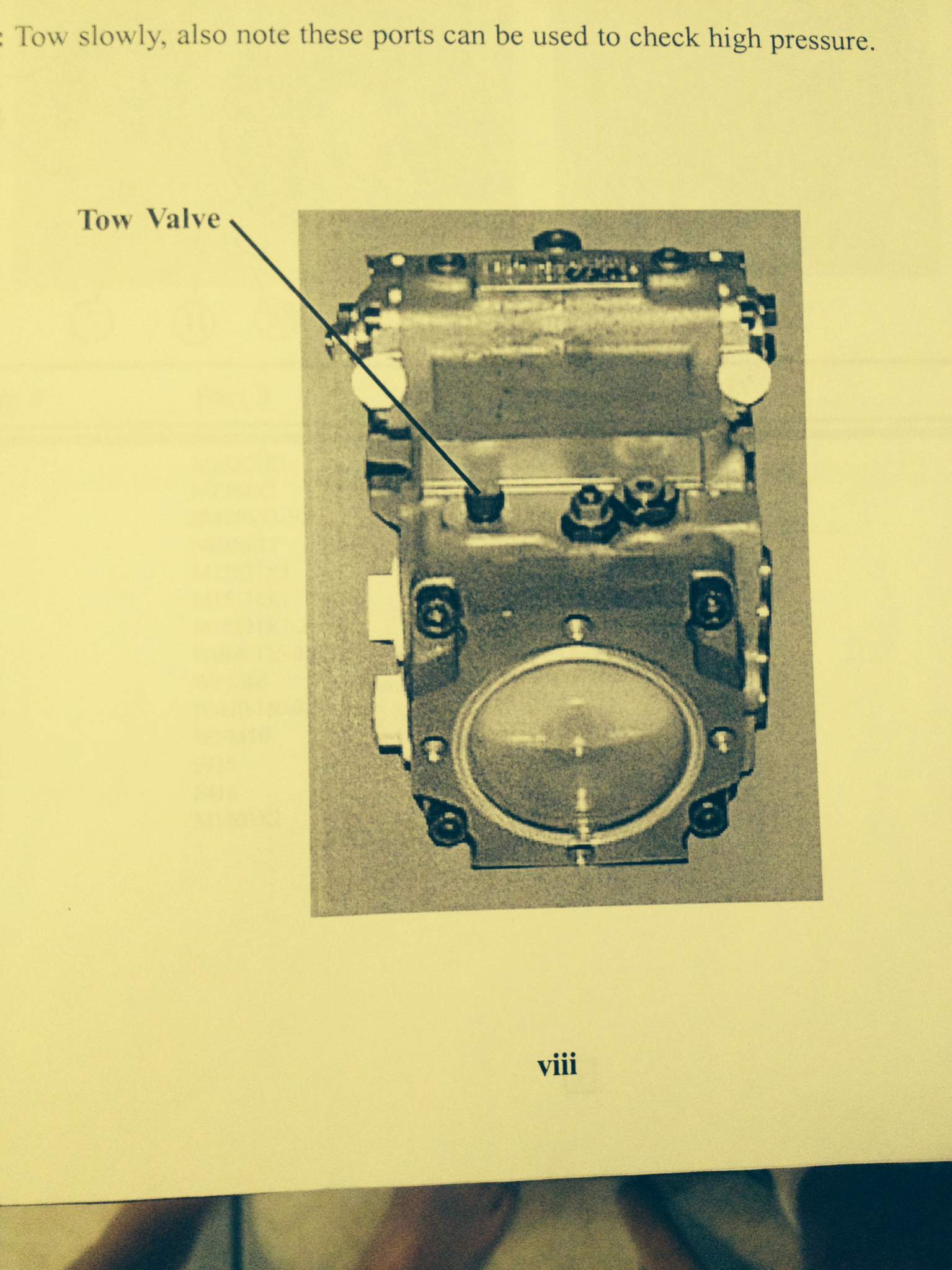

7 years 700 hours and first breakdown -- I turn key and goes up to 12/14 amps in run position, but when I move to 'start' position, all I get is a single 'click/thunk' like a switch moving somewhere and meter/lights go to zero. Battery is fine, but that is all I know is fine. I think my starter or solenoid is shot, but need to get tractor out of field to work on and diagnose the problem. I want to back-up a flatbed trailer and winch up the PT.
From the PT manual, it states to open the tow valve 2 turns... but then becomes a little unclear whether I need to attach some kind of a bypass hose.
From the manual:
"Open tow valve tow turns. The tow ports shown below have 90-degree fitting screwed into the ports. Attached to the 90-degree fitting is another fitting with a steel cap. Remove the caps from the fitting in each port and screw the jumper hose provided into the fitting and connect the two ports shown in the diagram. NOTE: Tow slowly, also note these ports can be used to check high pressure"
QUESTION(s) to group:
1.) the pic attached actually looks similar to my pump (except the valve on the far right has a fitting which leads to the draft control assembly)... but wouldn't a "90-degree" fitting look like an elbow?
2.) Is it really necessary to connect the extra hose? This just seems more complicated than it needs to be
3.) If I do have to connect a 'bypass hose'...what do I do with the hose that now runs from pump to draft control assembly (oh, and I never received and kind of 'provided' jumper hose at purchase -- just the single fitting open ended hose to bleed air after filter change)?
4.) do I call Terry or Duetz if my professional mechanic says "what the heck is that!!!"

And to answer your question about towing, yes, I believe that means you need to open those two ports and connect a hose between them. As suggested, call Terry at Power Trac for instructions. 1-800-the-yard. Good luck. :thumbsup:
   / Towing a 1430 #6
For my machine it was just to open the ports. No hose connection but I have a different machine (What a PITA if this is true).
