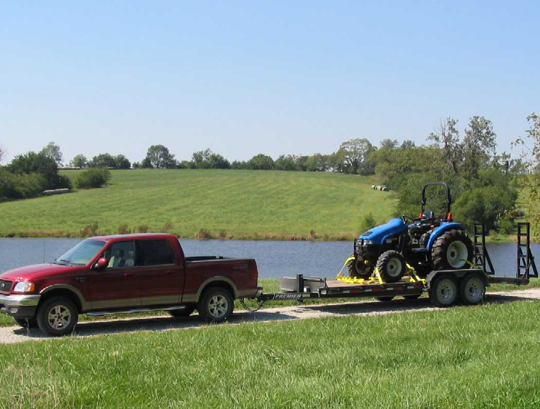

I've towed my TC40D with my F150, but it has the 5.4L. Here it is on the way to the dealer to fix a hydrualic leak. Later on, I actually towed the tractor with the FEL and a 800 lb Rhino BH on the. Didn't have a problem but I took it slow.
This is three weeks AFTER the dealer kept promising to come and get the tractor. I just couldn't wait any longer. It's around 50 miles to the dealer.
