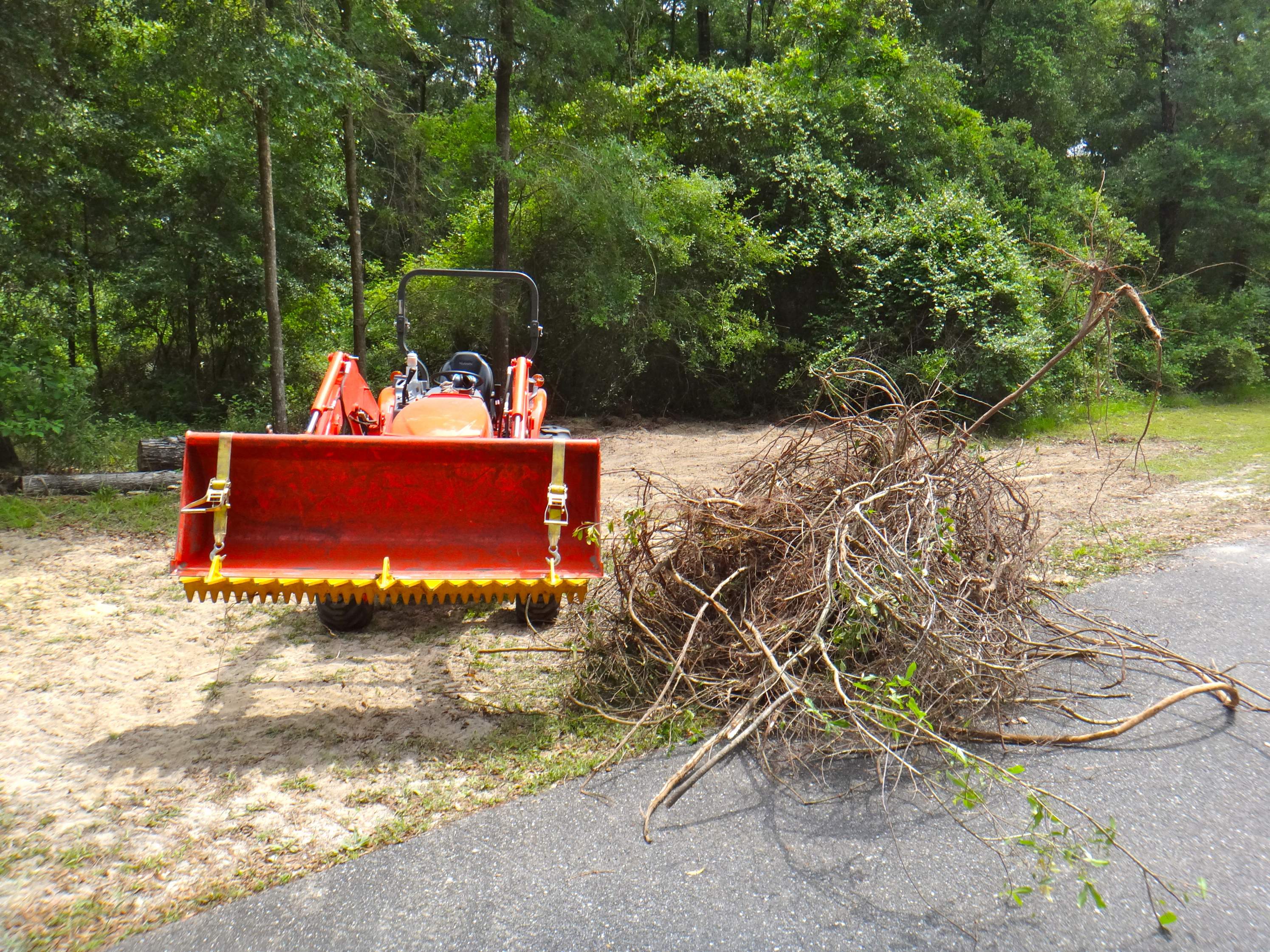

A $400 Ratchet Rake attachment for your bucket is excellent tearing out all manner of brush, collecting yard debris into piles, for spreading top soil and compost and for minor grading. Perhaps my favorite attachment.
Available through the T-B-N store with convenient UPS delivery.

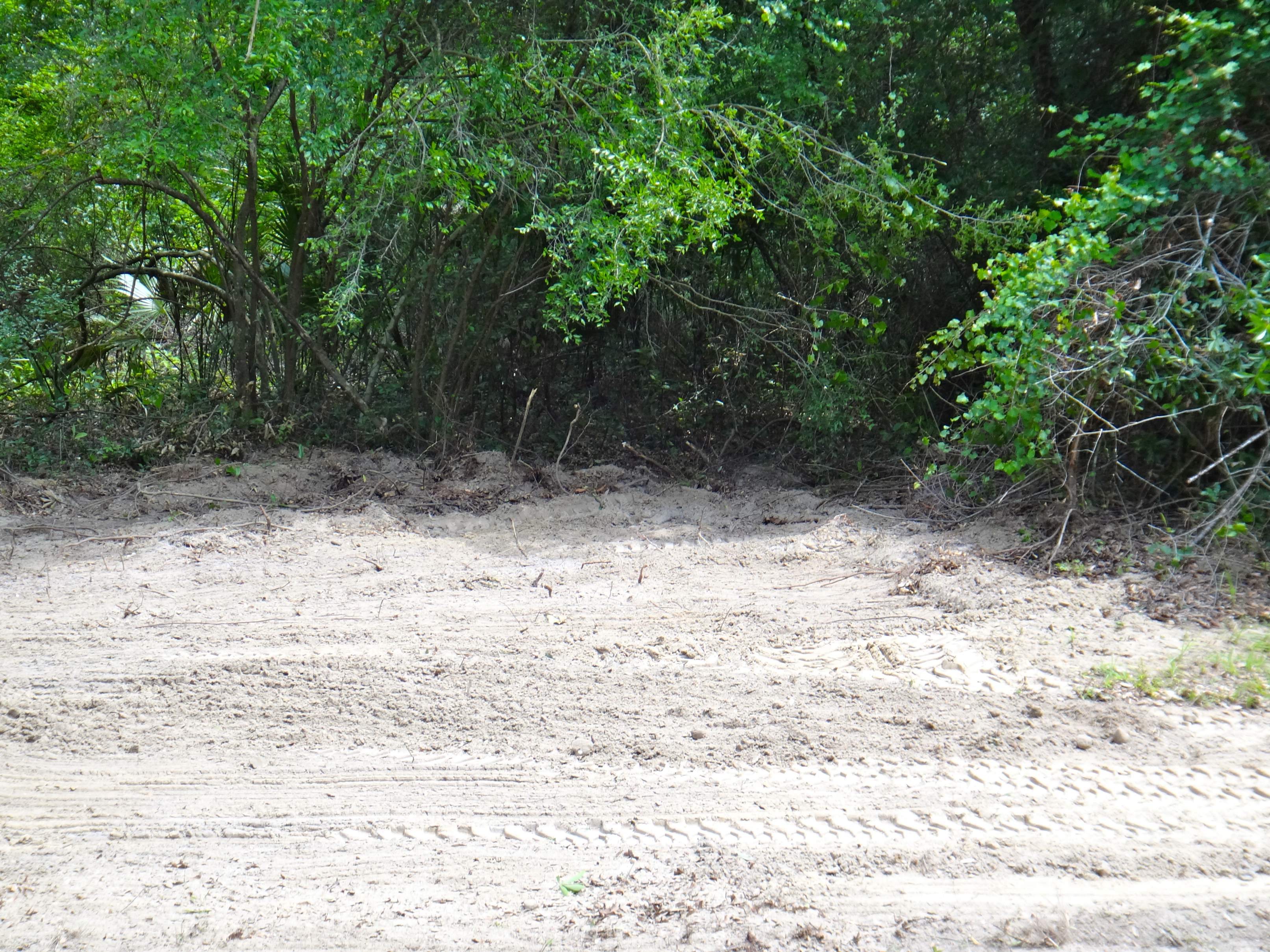

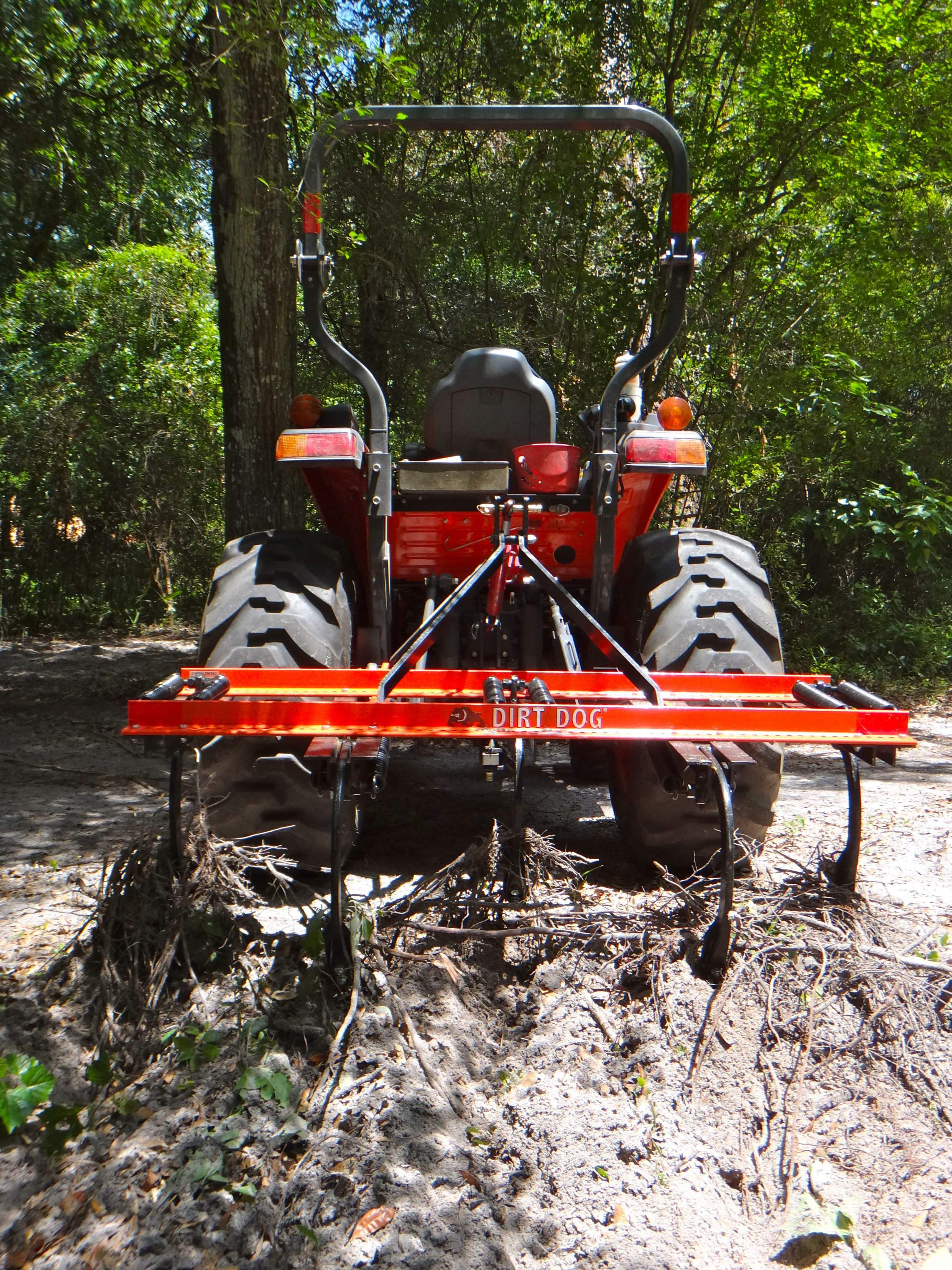

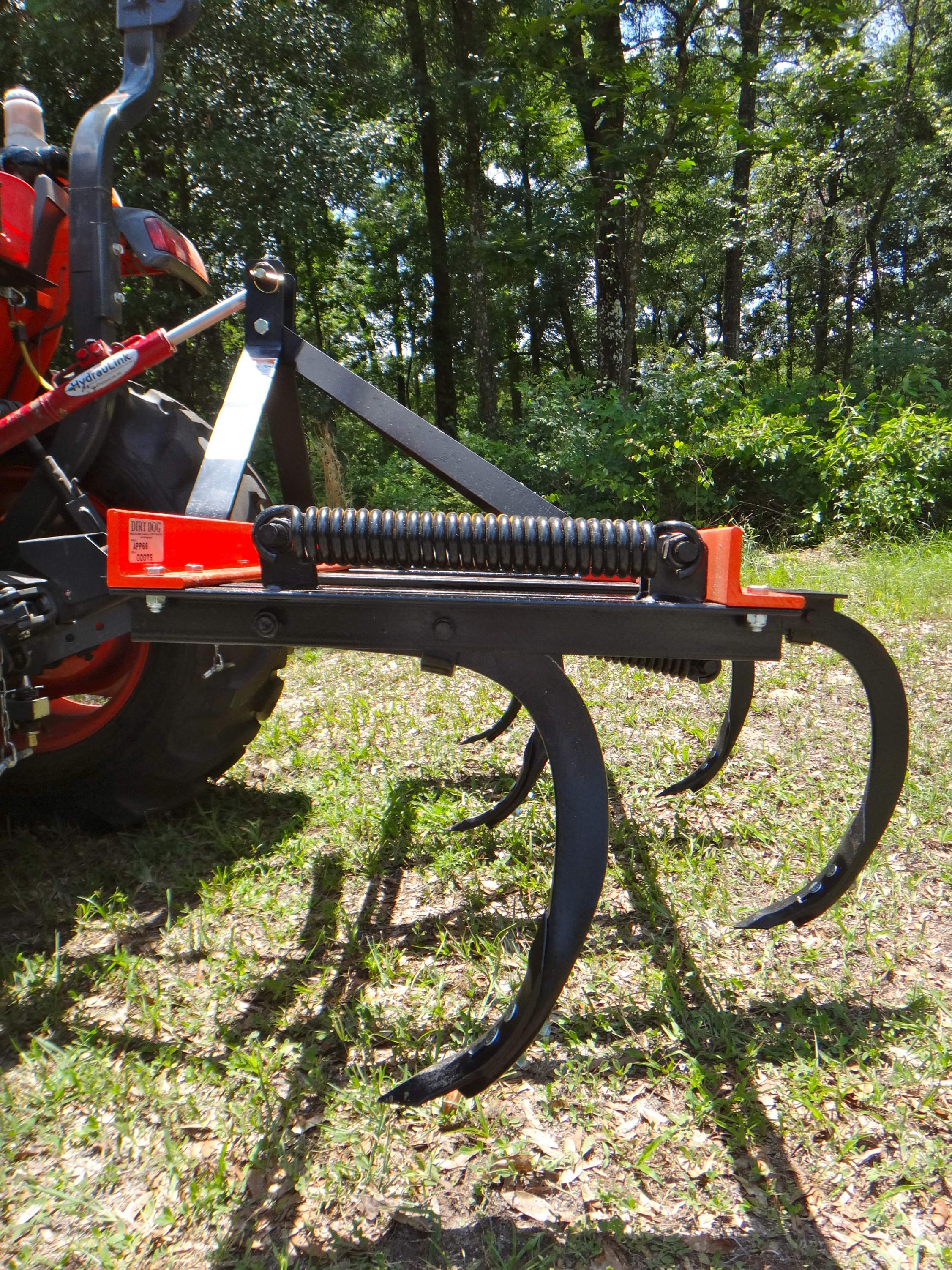

If you want a 3-Pt implement to tear out Honeysuckle by the roots, consider a $900, spring-protected Field Cultivator. You can adjust the tine spacing to, say, 36" and probably get most of it in one pass. Then spray the refugees with 2-4D herbicide.
My FC was manufactured by Dirt Dog in Georgia. Mine is 66"/5 tines. Dirt Dog also offers 48"/3 tines and 60"/5 tines. Fred Cain manufactures similar spec Field Cultivators.
