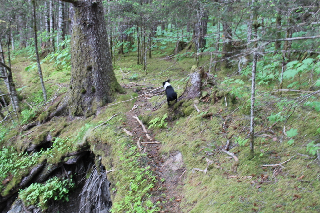

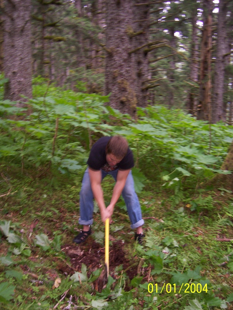

I found some pictures of the vegetation in the back ground as well as the trees to help give a better idea. my goal is to clear cut about 3 of the 5 acres COMPLETELY to allow the sun to get in and dry things out. Once the land is cleared the equipment would be used to dig water line trenches, footings for a home and then general grounds maintenance. I have found some good deals on the little 30 hp skid steers but not sure if that is a large enough piece of equipment.
As you can see there is a lot of under brush which necessitates a brush hog, and the Spruce are pretty large as well. I don't mind if things take a bit longer to complete as long as what ever equipment I choose can get the job done. I think a tractor makes all the sense in the world expect for the flotation issue.

Everything has its place. Skid steers are great for somethings and tractors are great for others.
I like the 7k mini ex idea because it's digging force will be better than the other two. But it's not a tractor and can't pull a plow or Bush hog or other rear implements.
The skid steer, if you get it stuck, will take another piece of equipment to get it unstuck and a pickup will be unable to pull it for most part.
A tractor with a backhoe can unstuck itself with a cable or chain and an excavator can do it without a chain in most situations.
Yes you can sink anything if you try hard enough but a tracked machine without an articulating arm, IMO, is more likely to be not what you need. Especially after seeing your pictures.
