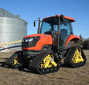

catvet
Gold Member
Aug 25, 2005
254
Hyde Park, Vermont
Kubota L-39
   / Tracks on Tractors (and other vehicles) #2
Those are awsome and I bet the price is awesome also. They make those for ATV's and I think they are in the area of $2500 for a small ATV. Have any prices??
Afraid I don't have prices. I also figure they are big bucks. I'm not seriously in the market so didn't have a reason to bother the manufacturer.

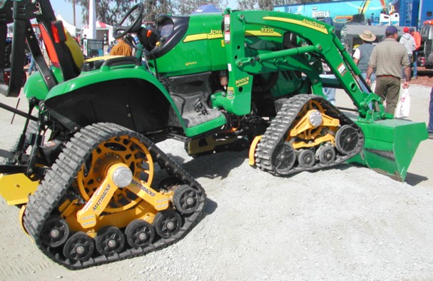

Yeah, those tracks look amazing. Here is a JD CUT from a recent AG
show.
RDB:
How about some pix of your creation?

There was a time you could get rear tracks with a bogie wheel for for the 8n's.
   / Tracks on Tractors (and other vehicles) #7
they work well for vehicals were the gearing is the same on all 4 corners.
but with tractors and ther MFWDA or whatever the h3ll they call it, the front wheels spin faster because they are smaller.
so you'd have to regear the front ends, or supply 2 diffrent sized tracks as they did for the JD to account for the diffrent sized tires.

I just called mattrack about a price on my JD 3120 and it was around $24000.00 for the whole setup.I think I am going to order a set this year sometime they are very impressive.
matthew3120
   / Tracks on Tractors (and other vehicles) #9
PLEASE, tell me you have an extra "0" in there....
   / Tracks on Tractors (and other vehicles) #10
I seem to remember seeing them a few years back for ~1600 or so each. So that would be $6400 for the vehicle.
