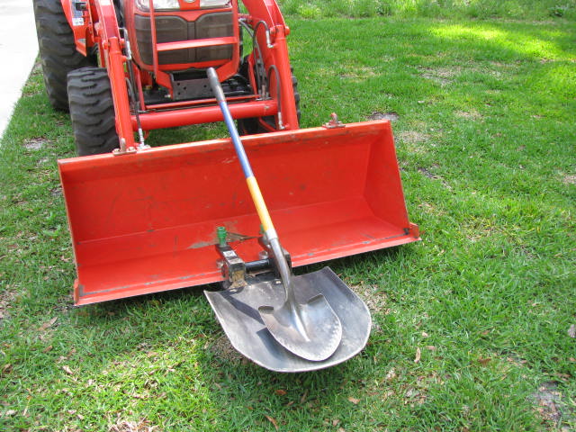

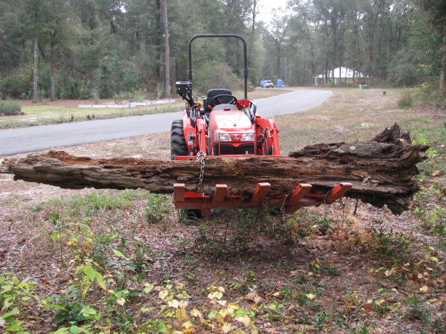

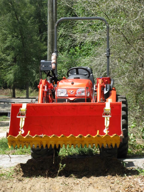

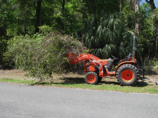

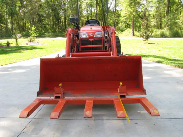

Many of us contributing to T-B-N use the FEL (Front End Loader) and bucket for 50% or more of operating hours. For me, possibly not for you, the lack of a Front End Loader would rule out this tractor for developmental ag work. The loader makes ag labor so much more efficient, serving both as a crane and powered, self-loading wheelbarrow.
